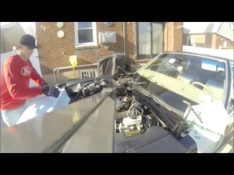

                  She's out!
                    Awesome!!
                      So halfway through that when it didn't want to let go, did your dad ask if you were sure you got all the bolts out?
                      I used mine engine crane yesterday too, but it was to move heater oil tanks. Not nearly as fun, and it certainly smells worse.
                            Nope. We knew all the bolts were out it was just slightly jammed on the converter and the motor mounts on the block were holding us up too. Dad was with me every step of the way unbolting everything so we were confident that between the two of us nothing was forgotten. Dad has taken the engine out of his mustang a couple of times so he has an idea of what needs to be done.
