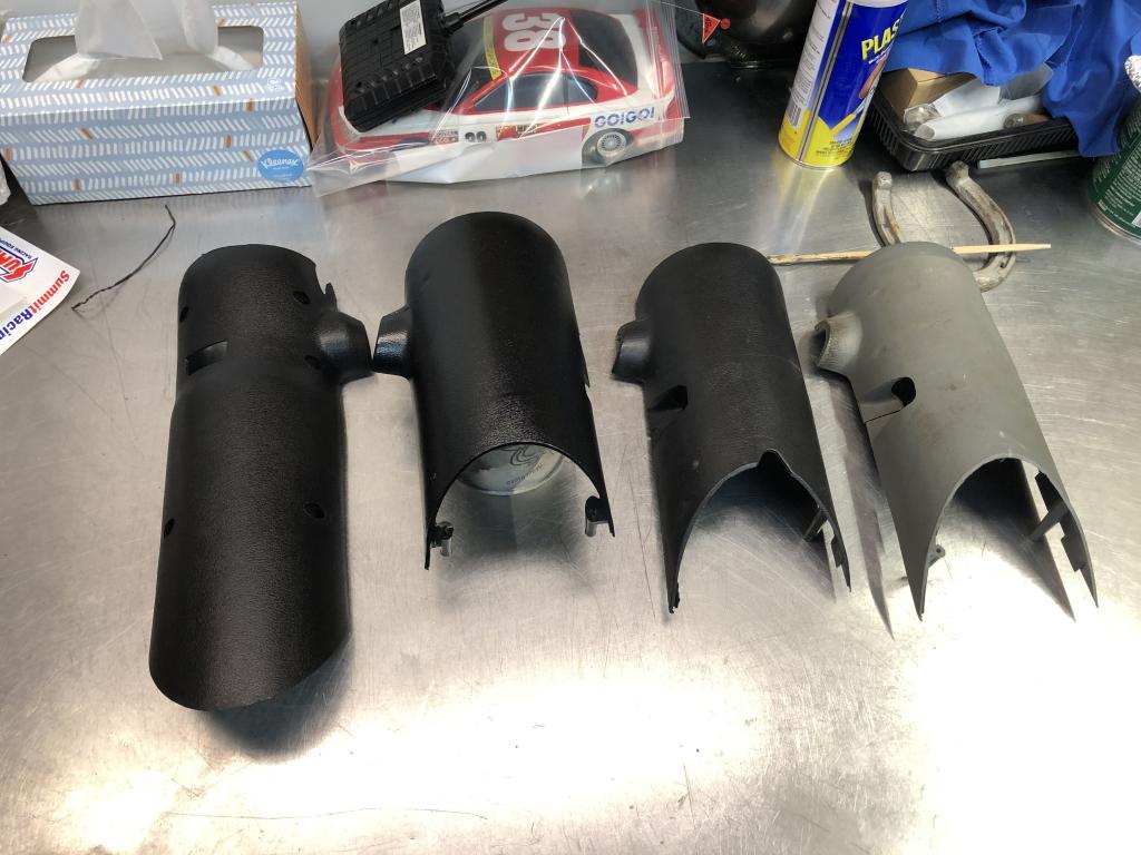

      Swapped in an upper tilt steering column cover from a 86 Mustang. It has no shift lever hole so I can complete the factory interior 5 speed look. This only worked as I already had a early 80's Thunderbird steering column covers installed. Panther steering column covers will not interchange (top of one bottom of other) with a fox body type. You would have to swap the whole shebang and the fox mustang one may not actually be long enough.
      Various steering column covers:
      Thunderbird lower, mustang upper, Thunderbird upper and panther upper

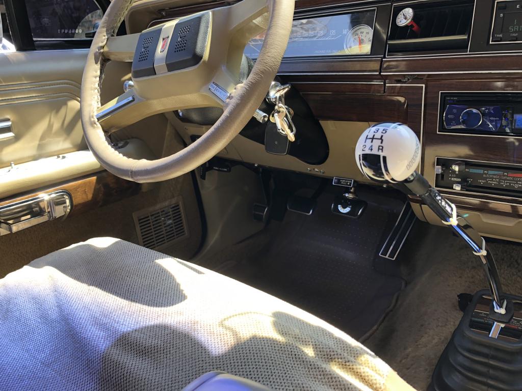

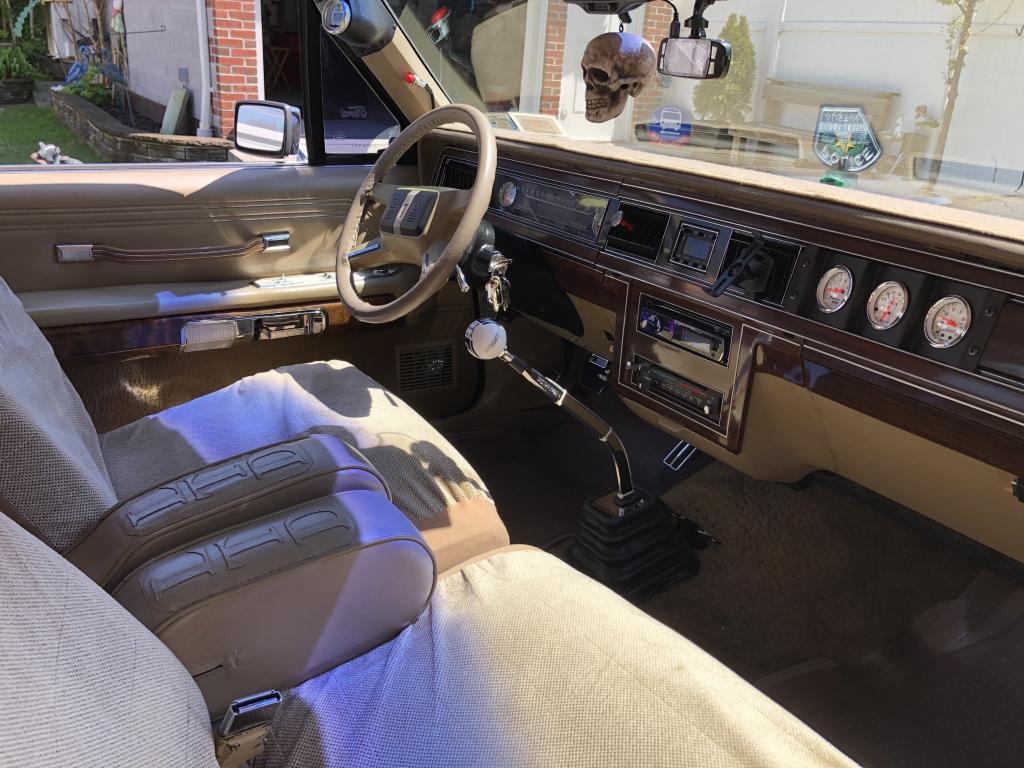

      And some up to date interior pics of the interior:

        I should have figured you would be the one to solve the funky column shifter remnants problem. Good work.
          Thanks
          I found the mustang upper super cheap on ebay and figured why not try it out. Turns out it fits pretty damned good with the thunderbird lower.
          The mustang upper and lower MAY fit on a panther column but the lower would then have a hole where the key release button is. This seems to be the best option.
          One may notice that the mustang upper column cover is shorter in length. Drivers side still tucks under the dash trim when installed. Passengers side leave a slight gap of under an inch. Hardly noticeable.
