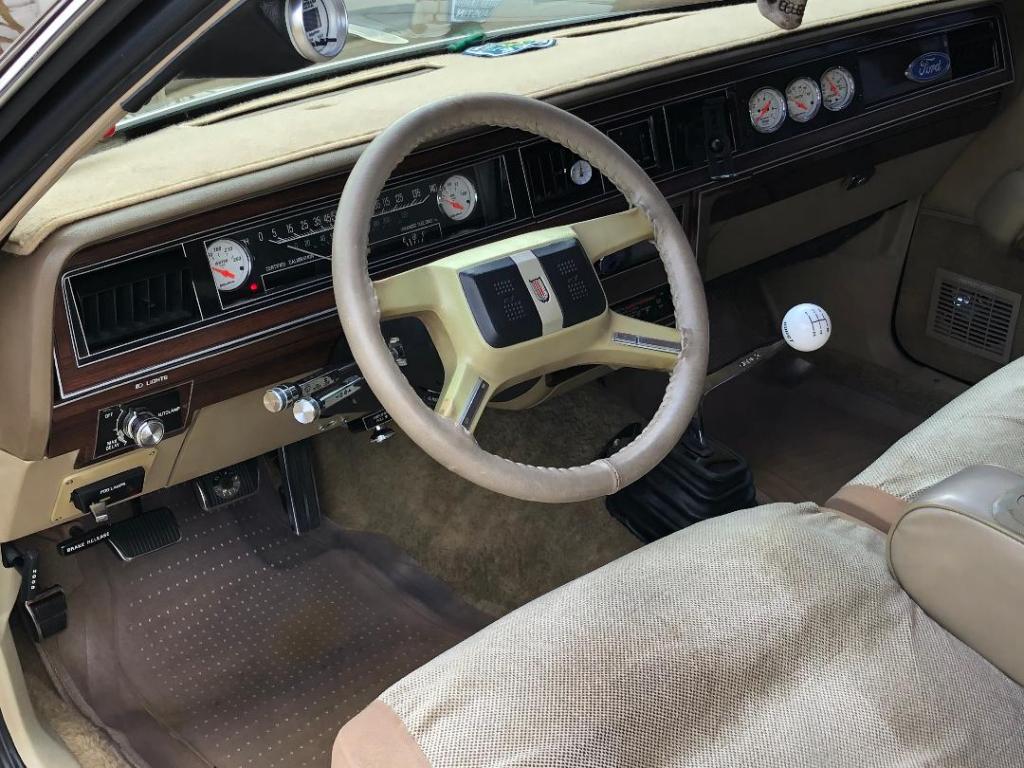

            Wow, this interior is spectacular. Really really dig it.

                    Thanks. I take pride in the interior. A lot of thought went into things and I try to make it look as potentially factory like as possible.

                        You know what I would do with that interior? I'd go modern on it...
                        Dark brown carpet, lower door panels and steering wheel/shrouds. Then light beige leather/vinyl on the seats, and upper door panels.

                          Gotta find a minty brown interior car and I can make it happen.

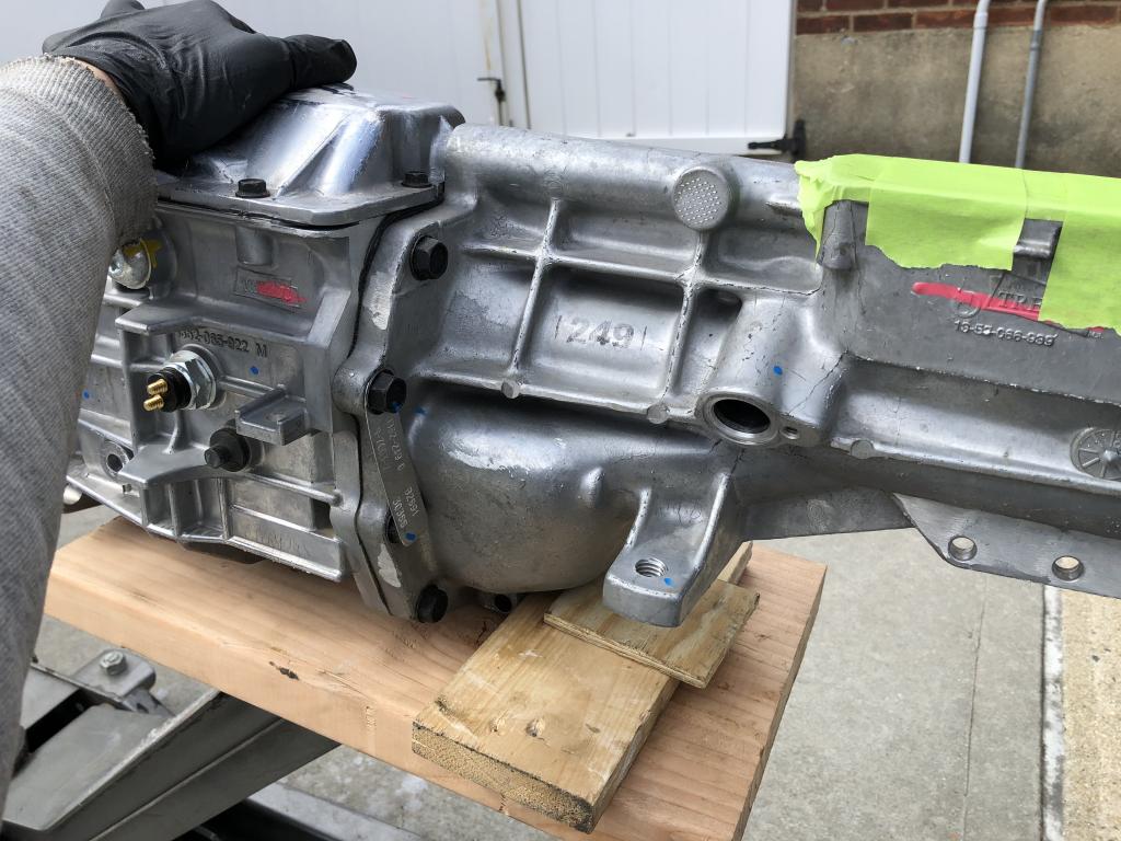

                            Some random pick of the 5 speed install. Did more work than picture taking...
                            The new trans:
                            The old AOD:

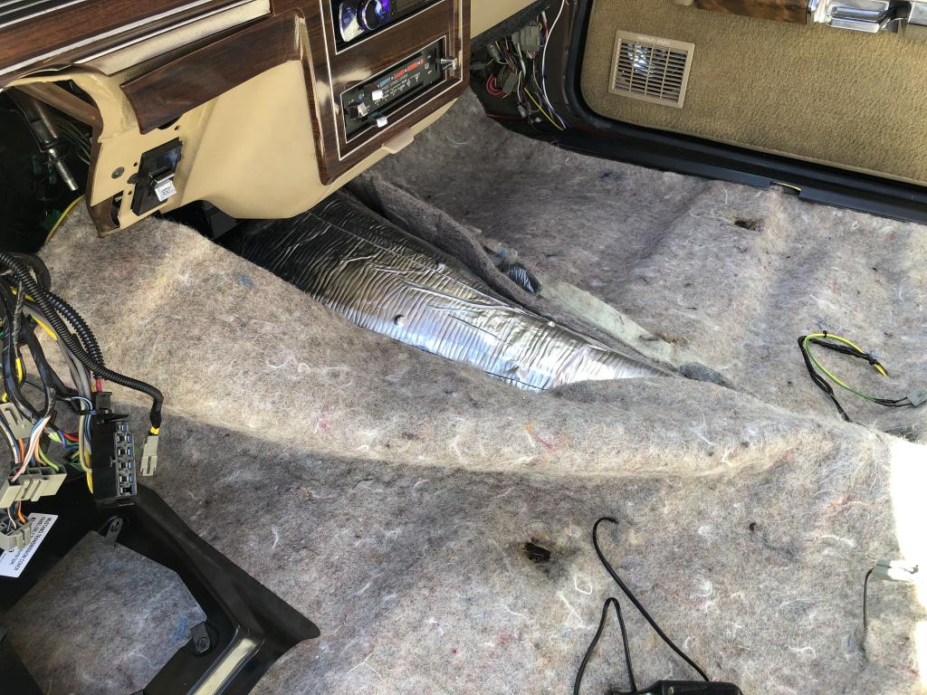

                            Some dimples in the floor I pounded from underneath to show me where to cut for the trans to fit:
                            The tremec T5-Z all installed in its new home:
                            Stick in no steering wheel:

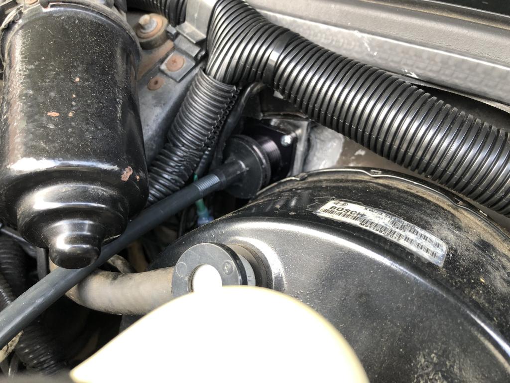

                            Piers firewall bracket for panther cars..a terrible pic of it:
                            Awesome piece. MUST HAVE. I bolted it in two places along the cowling/lip of firewall to windshield wiper areas as well as a bolt through the firewall just above the steering column. I modified it a bit to suit my needs but is an amazing foundation to start with. Sucker is planted and provided a nice sturdy base for a firewall adjuster and clutch cable.
                            A current (as of April 12 2020) engine bay pic:
                            You can see my new moroso catch can just in front of the receiver drier.
                            Also installed a raptor performance single mode shift light in the drivers side middle ac vent for stealthy points.
                              that brackets made a world of difference. it looks so much more sturdy. and still fits by the booster. thats an aero body master and booster, correct?

                                Does the firewall flex at all?
