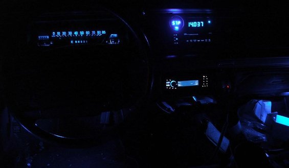

a little something blue
gigidy!
the gauges are oil pressure and volts...
the volts is just a generic volt meter circuit board I guess isnt suppoesed to go in a car becuase it needed a 5volt source I had to improvise, and it changes over about .30 volts constantly, I guess its not supposed to do AC power :confused: I guess I should have just used the one made by Stinger for cars, but it was bigger, cost more, and I had to try this drop in mount thing.
The oil pressure one is BRIGHT it hardly dims with the dimmer. I need to tint a cheap flashlight lens and cover that thing or something!!!
Plus it thinks below 40psi is dangerous and starts flashing at me as part of a warning modeso when I hot idle its sitting there flashing 27... 27... 27... 27 ... cold start reads close to 60psi, warm driving around 40.
Oh the dremel got away from me in a couple parts, dont trust a drunken dremel hand! You can see it up close, its not too bad, still less of a hack job than the police gaugesPete ::::>>> resident LED addict and CFI defector LED bulb replacements
