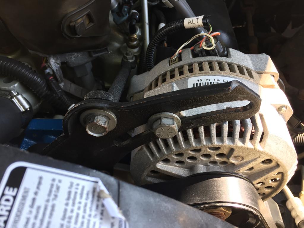

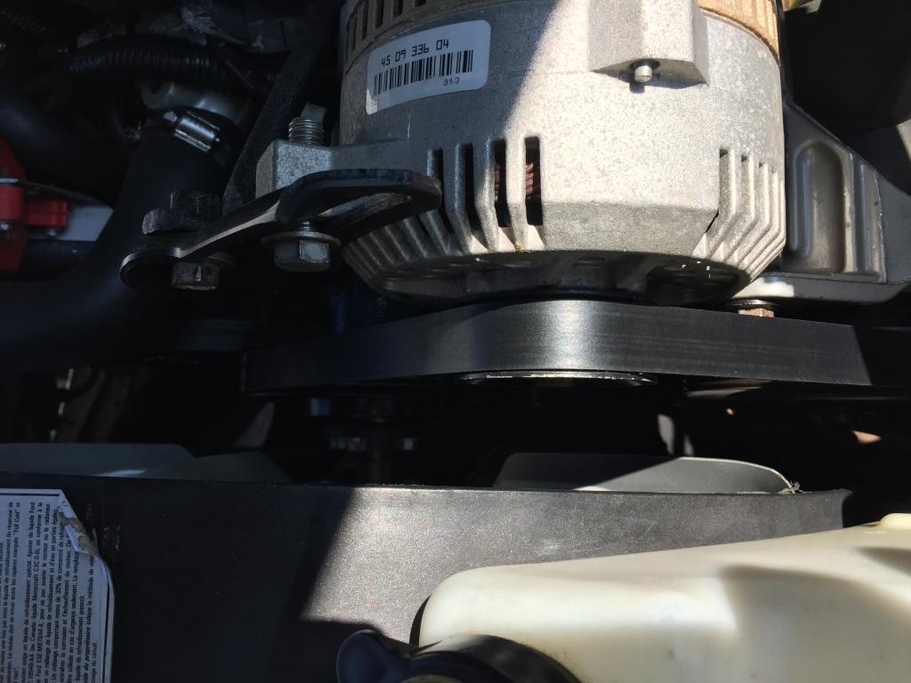

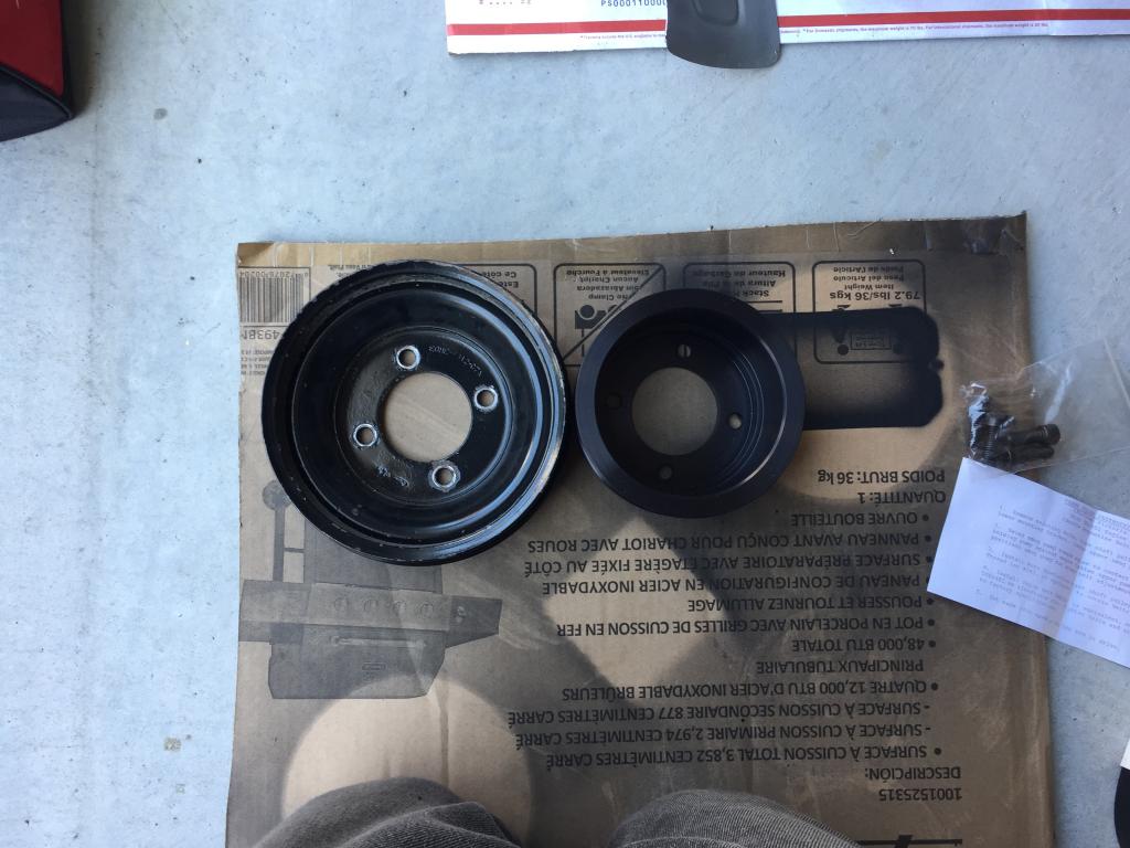

                A while back I slapped on the underdrive pulley from ASP.
                You can see the under drive pulley is mega small when compared to the stock one.
                AC belt used: Gates 060532 Fits perfect.
                Alt belt used: 5060485. Fits MEGA ULTRA TIGHT. Want to pick up a 5060490. That should do it.
                I have a mustang 95 3g alt on the car, that may be the reason for the super tight fit.
                Car revs like boss. Have not driven it around yet. Had it running at idle for well over an hour and all is normal. Seems successful.

                  forgot to mention, my 3G has the smaller 2G pulley on it. Its not a big difference in size but its probably enough to make a difference. Might be worth doing now that you've got the underdrive, it will slightly boost idle charging performance since it will speed up the alternator a tad.
                    Yes. I figured the alternator pulley was the factor at hand here. Though the voltmeter was still around high 13's during that hour long idle test it certainly cannot hurt swapping to a smaller/stock sized one.
                    I no longer have the stock alternator (to my knowledge) so it has been added to the JY parts run list. Any idea what socket size is needed for the pulley removal. Zipping it right off at the yard is the way to go.
                    I literally had to remove the alternator completely and somehow walk the belt and alternator on at the same time. I was PISSED. Plus no local store had the 5060490 i would have needed so it was my only option. I was not considering swapping the stock crank pulley back on!
                      15/16" The MegaMerc did not give satisfactory voltage after the 3g w/stock crank pully. I swapped a smaller pulley from a 2g and it became happy.
                        Also, some pulleys have a spacer, be sure to capture it.
                          15/16" socket indeed for that nut. And keep in mind there are at least two 2G pulley sizes, one as small as 1-7/8" IIRC. What sucks is the Panther belt routing has shit for belt wrap around the alt and PS pump, makes it super easy for that belt to slip. Someone needs to figure out how to add an idler pulley between the alt and pump, that will greatly improve the situation.

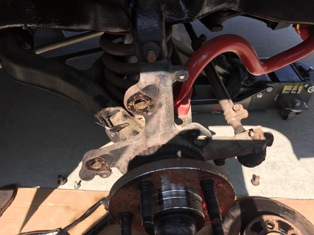

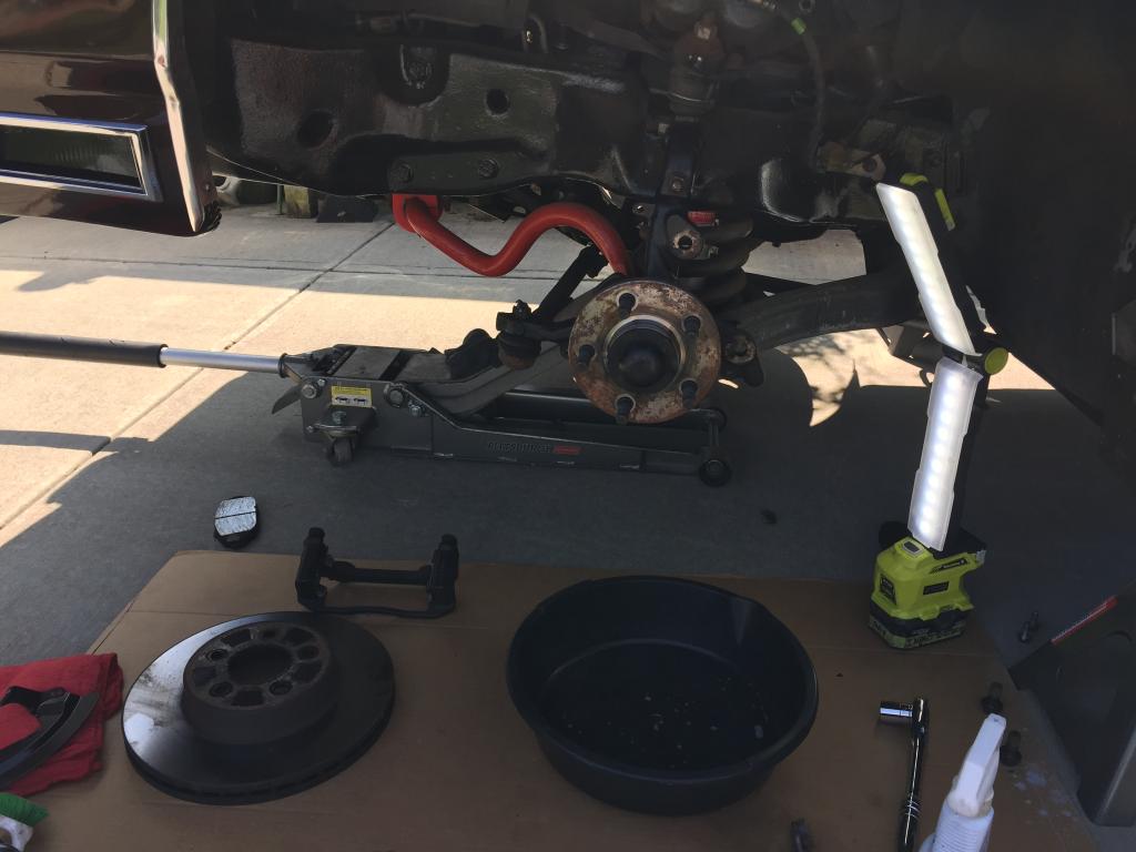

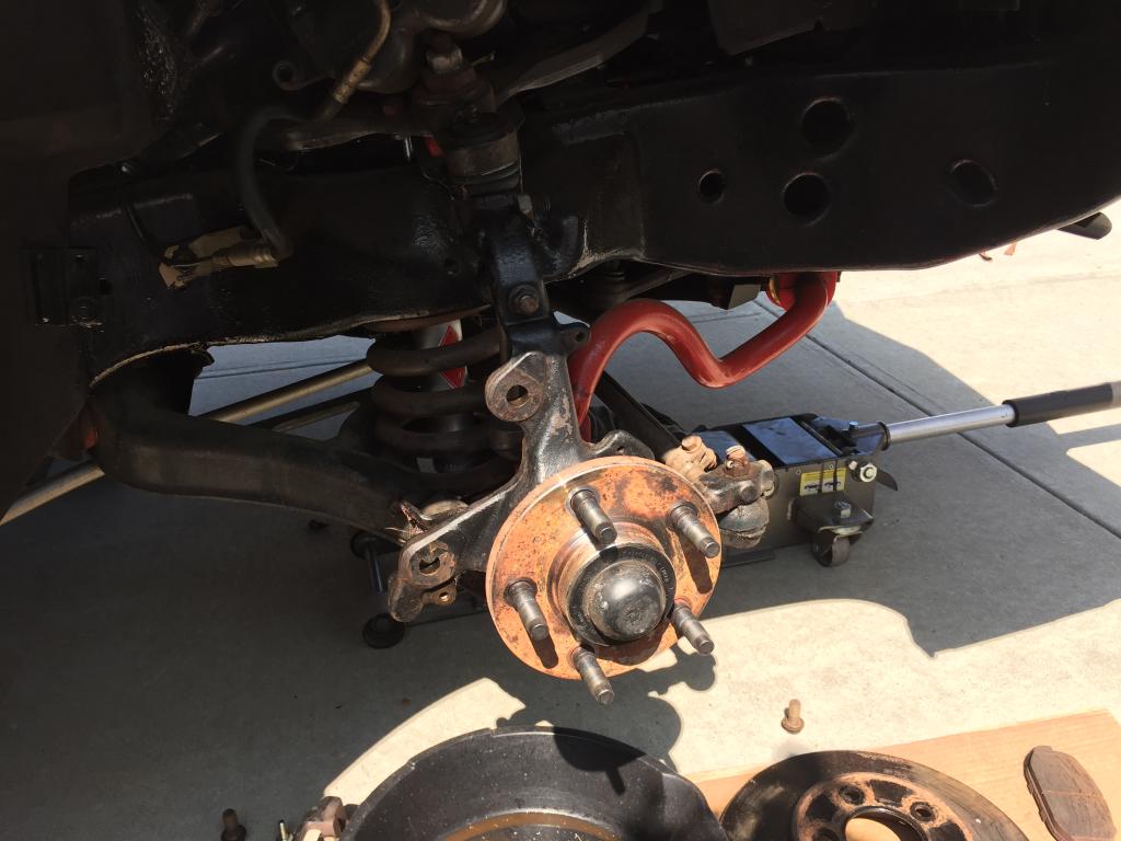

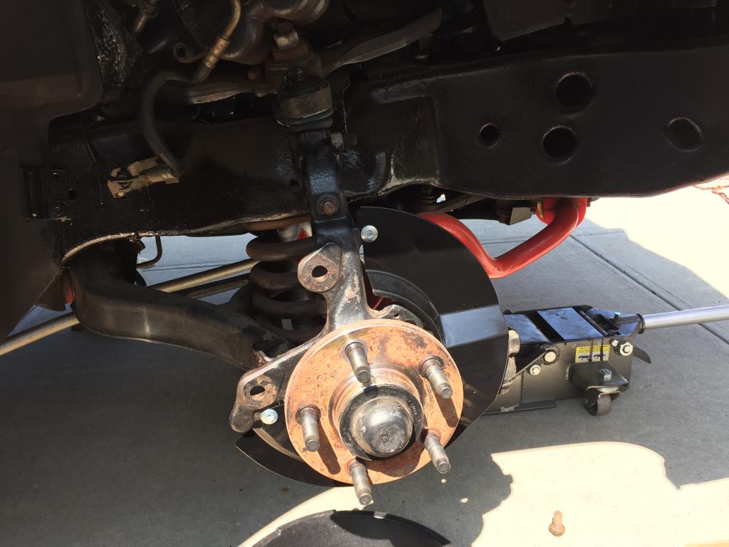

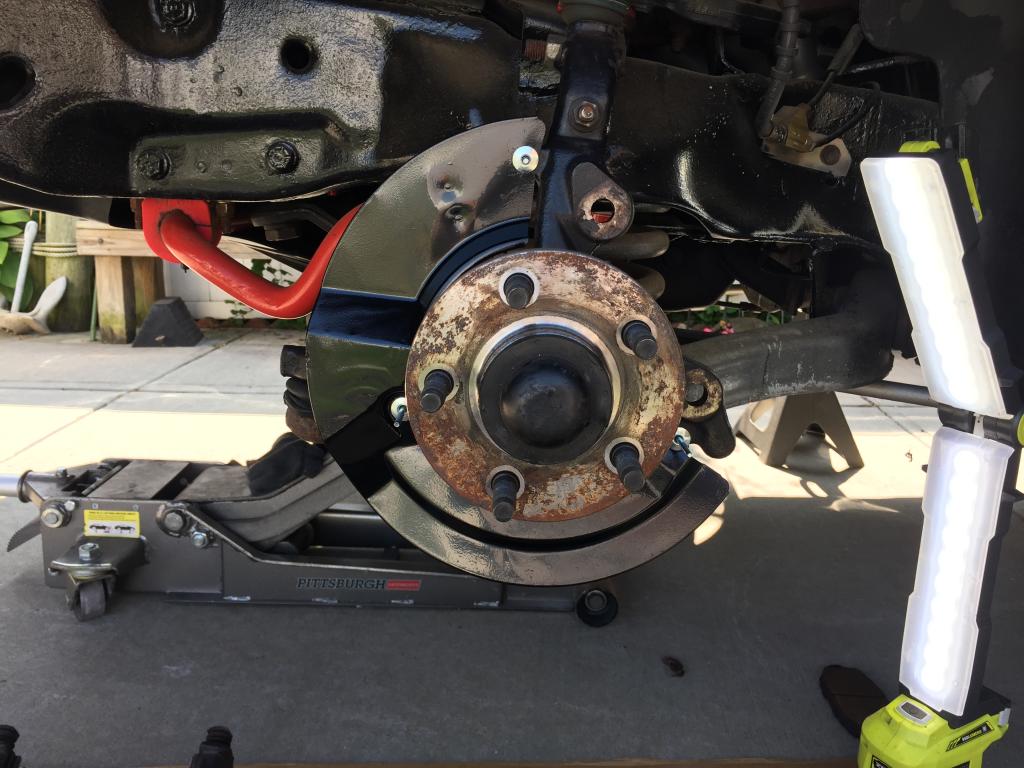

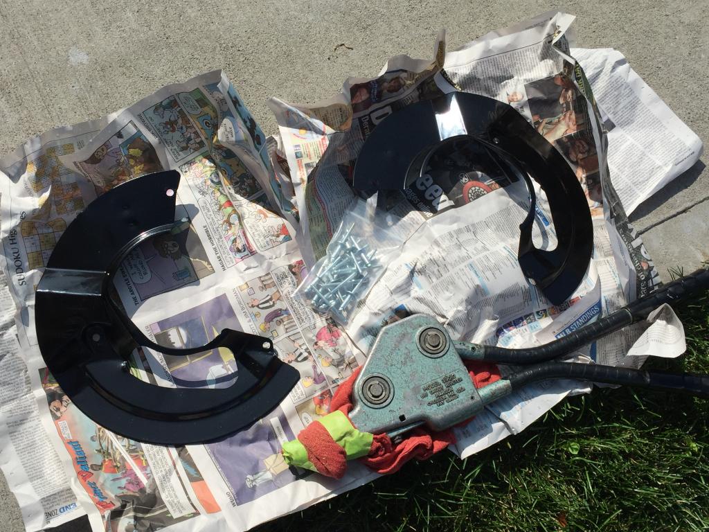

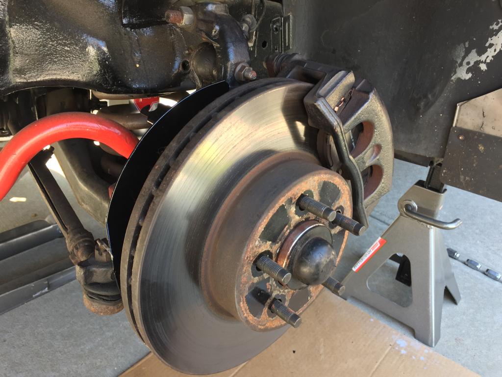

                              Got the front disc brake splash shields on. Went super easy. Only the passengers side had the three rivets left for me to remove. No biggie. Looks good.
                                Some last pictures from the passengers side install:

                                And some from the crank pulley install:
