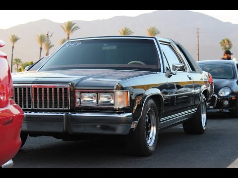

        Well ladies and gentlemen, we broke into the 9's.
        Went to Irwindale Dragstrip in Irwindale, CA 7/29/21 and ran the 85 Marquis.
        DA was 1200
        First pass I ran a 10.04 @ 68.38 with a 2.16 60ft.
        I was ECSTATIC on ALMOST cracking the 9s, and I knew that I could run a 9 that night if I made some minor changes.
        I dropped the tire pressure 4psi and tried launching about 400rpm higher, and the results really showed.
        I dropped almost a tenth of a second! Second pass I ripped a 9.95 @ 68.89 with a 2.13 60ft.
        (sorry that it's sideways)
        I am still working with the stock bottom end, stock cam, stock CFI unit, stock E7 heads
        Mods can be seen in my signature.
        Next will be the hydraulic roller conversion (I have a stock Cobra cam that might play nice with the CFI unit).
        I'm also considering some 1.7 rockers, as the rockers I had in there gave me some trouble, so these times are with the factory rockers.
        I also have some new Tru-Coil springs and some fresh 8.8 Diff bushings that can go into the rear to maybe turn a 2.0 60ft.
        So, can I claim fastest CFI powered Marquis yet?
