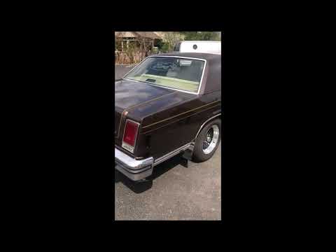

                      A video of some prior wheel hop to refresh memories:
                        Box Panther back to terrorizing the neighborhood
                          Yessir.
                          Buddy wanted some sound to show his kiddo back at home.
                          I upped the tire pressure 5psi in each tire to around 36. Seemed to have alleviate a majority of the wheel hop. While moving it was just leaving straight black lines and no hops...could also be a flatter road. More testing needed.
                            I'd forgot what a good small block sounds like. Very nice.
                              Thanks. I just cant understand how the audio gets a bit messed up when putting it into the editing program from the phones recording. Aside from that slight nuance I am quite pleased with how it sounds in person. What you hear is what I head but with some slight noise.
                                probably something with the audio compression. Tends to make things have a slightly nasal sort of sound.
