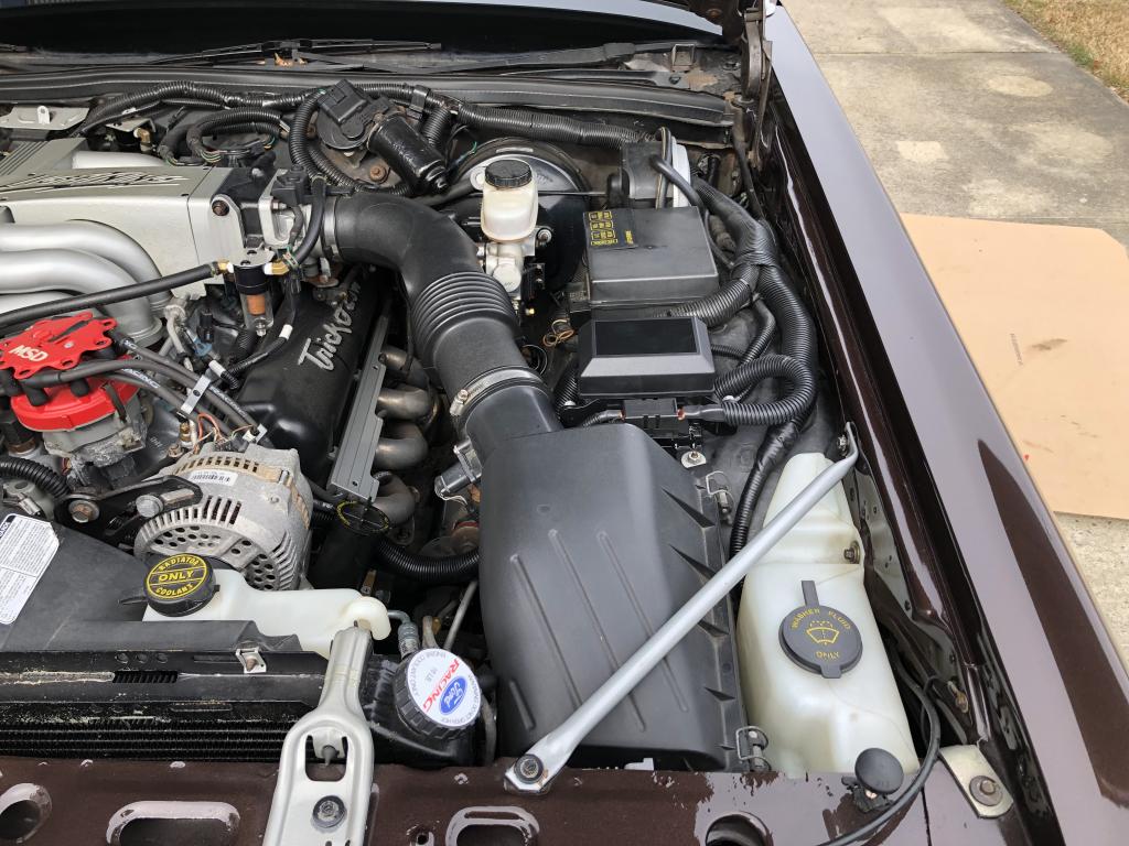

        I think I will be going the delete route. The car has so much altered and added wiring (because of upgrades and such) that it is kinda pointless for me. Just an eyesore.

                    I axed the ugly salt shaker connector over by the air box/washer fluid reservoir....you know...this one:
                    and now:

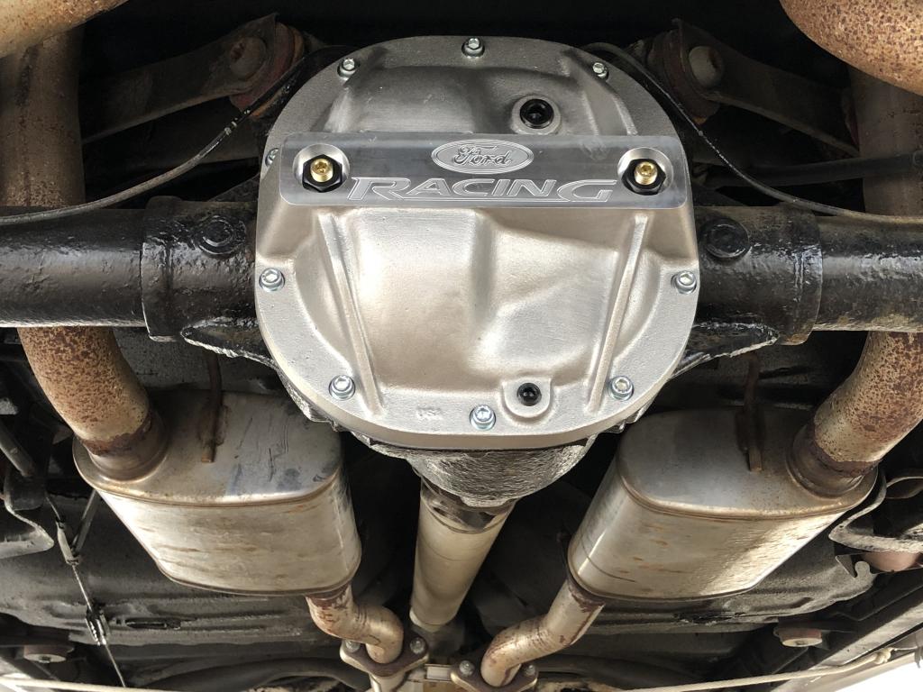

                              In preparation for the mans trans I have installed an axle girdle. Seeing the ring gear fly out the rear cover is cool but I dont want that souvenir.
                              Old set up....
                              New set up....

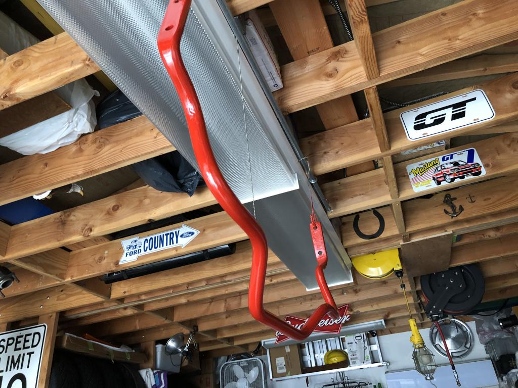

                              Painted the rear sway bar to match my front one...
                                honestly the rear-facing fill and drain plugs are almost enough to warrant one. No drain and having to fill it from the other side where access is poor sucks.
