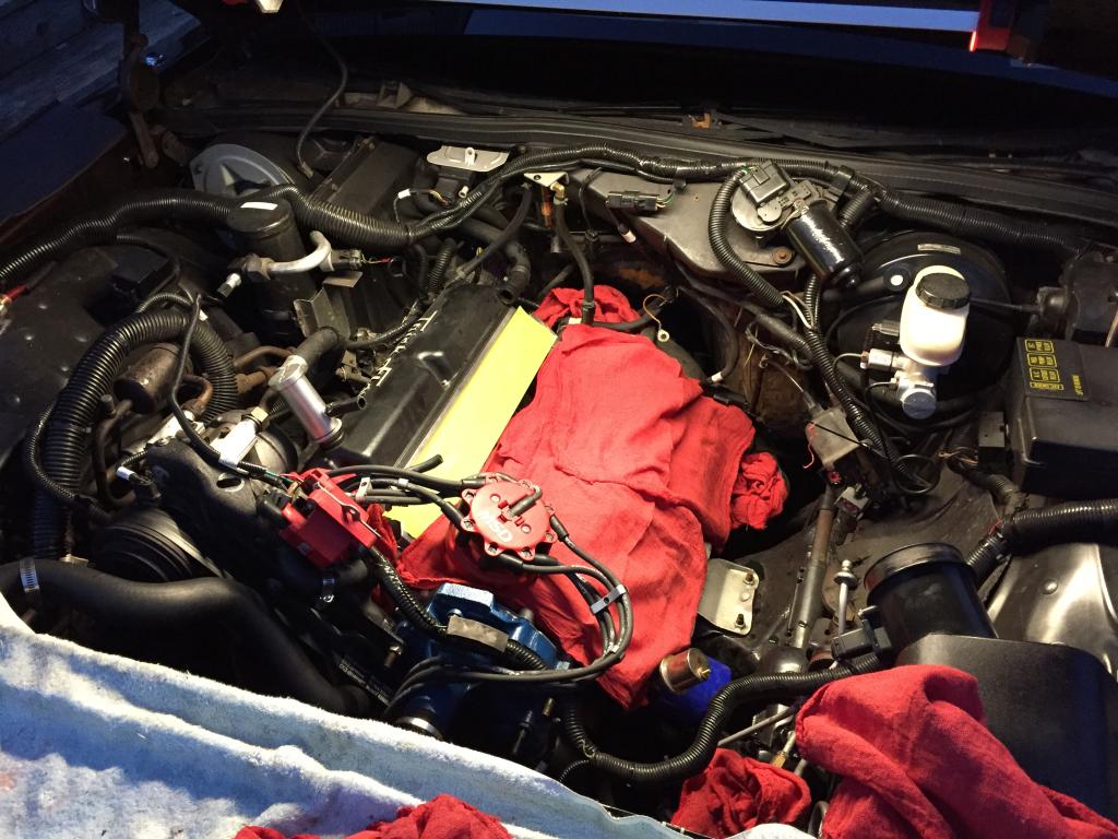

    'bout half way there...
      Ya poor bhastherd... You must be really good at that now.
        Started this mess this afternoon.
        Removed upper intake, drivers side header, alternator, fan shroud, fan and drained coolant. Just about to pull off the power steering pump pulley and the sky's opened up so I had to call it quits.
        Quick recap...end goal is changing out drivers side head gasket, swapping in a t moss ported gt 40 lower intake and swapping in a new power steering pump and high pressure line. I have the newer steering box so I have to cut and re-flare the high pressure line of the pump to adapt to the newer steering box' stock high pressure line.

            All bits from old lower intake are now swapped onto the T moss ported lower intake and ready to go.
            Plan to clean out the threads in the block and p.side head and suck the coolant out of the lower head bolt areas and slap the head on tomorrow. Working outside kinda sucks..No not kinda but does A LOT.
              Got the head on a torqued as well as the lower intake. Next up I want to drop the dizzy back in and then install the push rods and rockers.
