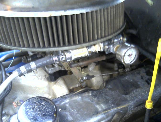

                            Well, my worries about the vibrating canister-style fuel filter proved more founded than I had imagined, as this morning the aluminum hardline broke off entirely from the filter inlet. Got doused with fuel whilst discovering the nice forward-spurting fountain in the engine bay, then patched it for the trip home by hooking the still-temporary rubber hose from the regulator to the carb, directly to the broken pressure hardline. Odd that the negligence of never having finished the aluminum-hardline project saved me having to get towed home, or else tried to talk my wife into bringing me tools and parts. Still, I lost at least a quarter tank of gas to that incident, just spewed out all over the ground and header panel.
                            I realized later that it may also have been fortunate that I'd paranoidly swapped to a passenger-side ignition coil arrangement; since the old coil and wire seemed to be leaking a little voltage, this may possibly have saved me from getting to test out my fire extinguisher.
                            After I got the piece of junk back home, I scared up some random surplus fittings, along with my old crappy Spectre see-through fuel filter, and cobbled together something that at least runs the fuel through a filter and through the regulator. I realized that I probably should have done this arrangement with the regulator before, only I couldn't have since I originally pressed it into service *before* I had modded the carb lid for the driver's side 3/8-NPT inlet. Thinking I may end up leaving the regulator right where it is and doing something different filter-wise. Note that the arrangement pictured here is only temporary, until I decide what exactly I'm going to do (like mounting the Fram HPG1 to the fenderwell like I should have done to start with) that won't sort of up and break.
                              One concept that occurred to me might be to install the huge HPG1 *before* the fuel pump. I wonder if the pressure drop across the filter would be little enough to make that a reasonable thing to do .....

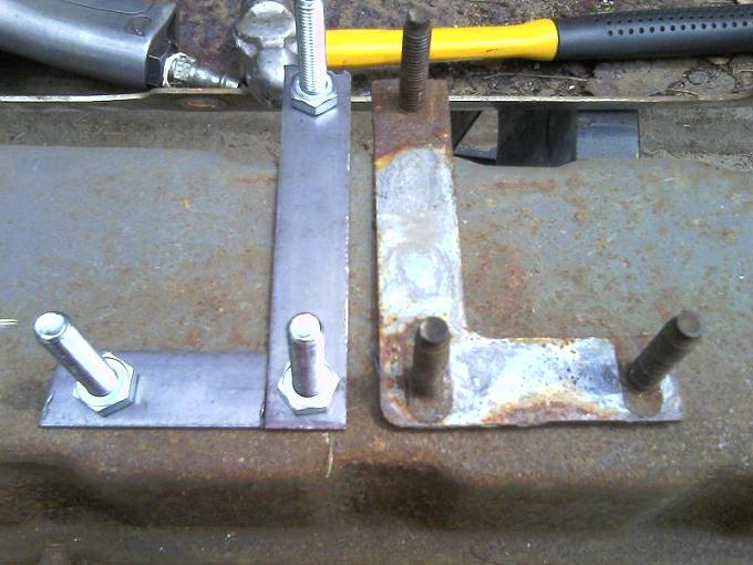

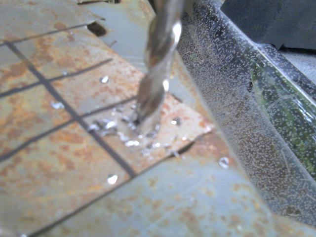

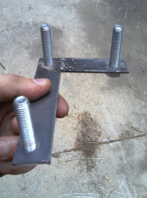

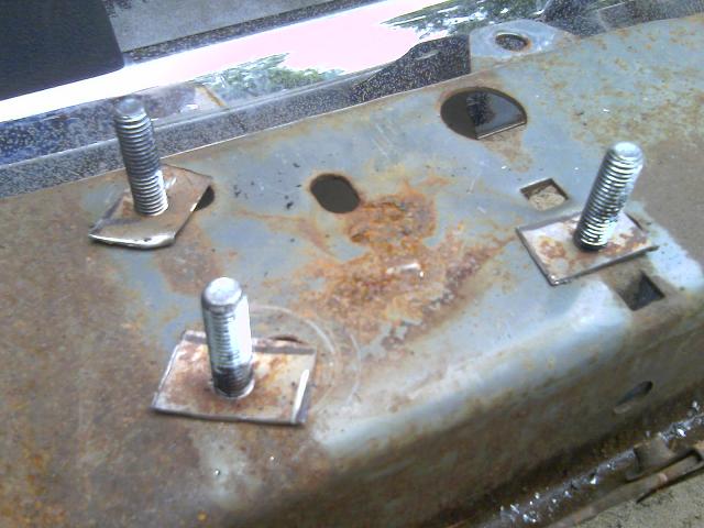

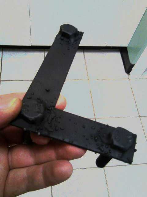

                                ..... and here's a thread on how to make said mounting plates. http://www.grandmarq.net/vb/showthread.php?t=39979
                                Highlights:
