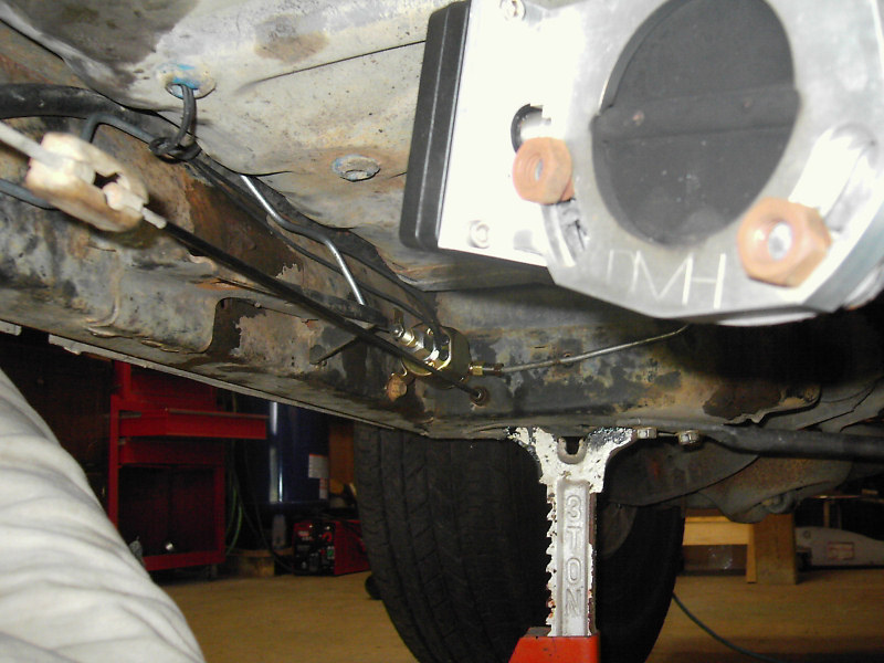

    I have it mounted in situation two style. I love it, one really nice thing I can do is easily do a rolling burnout, or do donuts and then return to a stationary burnout without applying the rear brakes. It is also very easy to mount and install. If you are good with making the double flares you will not even need new brake line. You can use the existing line without having to relocate it or even bend it. I replaced one piece on mine, but only because as I pulled it off it started to leak through a rust spot on it. Directly under the driver side behind the wheel in the corner of the frame is the perfect mounting spot.
    Here are some pics of where I have it installed.
            anyone else see the bondo on his floorpan in this pic??....install info, i need details, like exact instal instructions

                I don't see bondo. Not much for the install really. Whack the line in half, flare it like you're putting in a connector, and thread it into the line lock instead. Might need to trim the line slightly to make it fit all purdy like. Wiring goes to a switched 12v source.
                  I don't see any bondo either
                    Deffinitly no bondo, where do you think you see bondo? As was said, very simple to install. Cut, install thread fittings, then flare, then bolt it up. I drilled a small hole in one of the floor drain plugs and fed the wires through there. Made it a small hole so that it still seals.

                              All the line locks I have seen are mounted up near the master cyl. It's more prone to damage/corrosion where you mounted yours.
