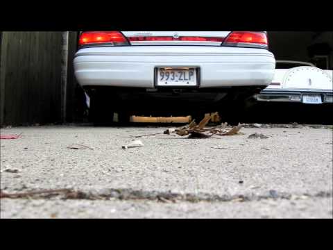

                          I can agree with that statement. I like to hear it, but I don't like to advertise through it. I like it to be mellow and only bark when it means it (WOT).
                            Hard row to hoe, unless you have a pretty healthy engine with pretty mellow exhaust, although some vehicles can pull it off better than others.
                              kinda like this one... doesn't drone on the highway when cruising... has a bit of a rumble, but not much, but yells good when I get on it.
