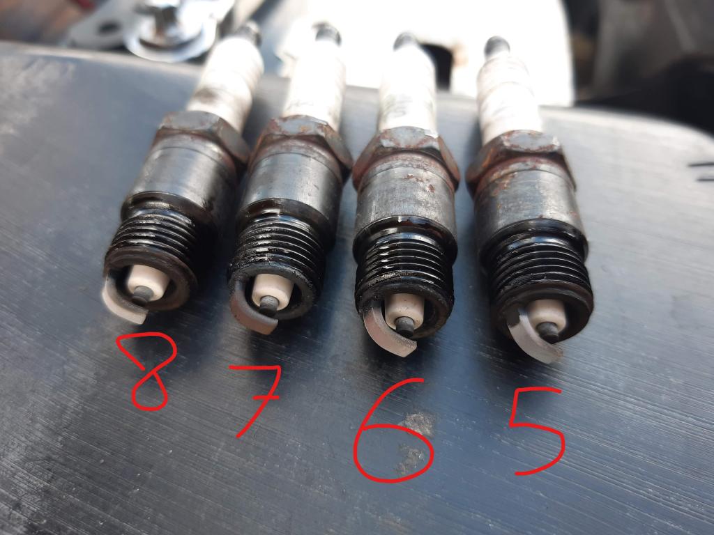

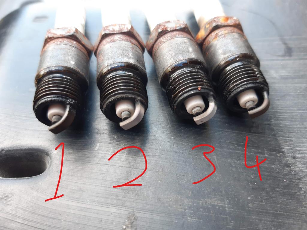

      Those numbers sound good to me. The plugs look good too, how many kms/miles are on 'em? The ground electrode on #1 & #7 (possibly # 4 too, possibly just the lighting) look a little wet compared to the others, but none are the smoking gun I was hoping to see. With the engine that came out of my truck, #1 was CAKED with carbon/oil all in the spark plug gap.
      1985 LTD Crown Victoria - SOLD
        Here's the problem with those plugs:
        The shop receipt from a couple years back says 8pcs of NGK UR45. Which those are NOT, those are some rusty old ACDelcos. I have no clue how old those are or how many miles are on them.
        It seems I was bullshitted on those plugs, or the mechanic put the old ones back in if the NGKs made no difference.
        To me most of those plugs look way too white, which would indicate those getting hot.
        I THOUGH I HAD NEW-ISH PLUGS.

          Did I not mention a misfire? Good job on NOT assuming anything and checking thew plugs and wires!!
            Yeah I was thinking it was a misfire aswell, but it took me long enough to question the shop receipt that says I have new plugs. I have no idea how much money and time I've wasted due to a bullshitting mechanic.
            1985 Mercury Grand Marquis LS, "Maisa"
            2005 Volvo V70 Bi-Fuel
              Unfortunately, it is the folks we trust that disappoint us. You did ALL the right things, checked even things you thought were fine and narrowed down the problem (or at least part of it). I congratulate your persistence and hope you have many years of enjoyable driving on this car. Having an older car is a challenge - something always requires repair but that is part of the "charm" of older car ownership.

                    White also means a lean mixture, which is what I'd be leaning towards and what I'd prefer.
                    Perhaps there is some bit of crossfire going on, if changing the plugs and wires made a big difference with your issue. At night, try spritzing some water around all the plugs, coil, dizzy cap and along the wires as it runs. If anything changes, investigate further.
