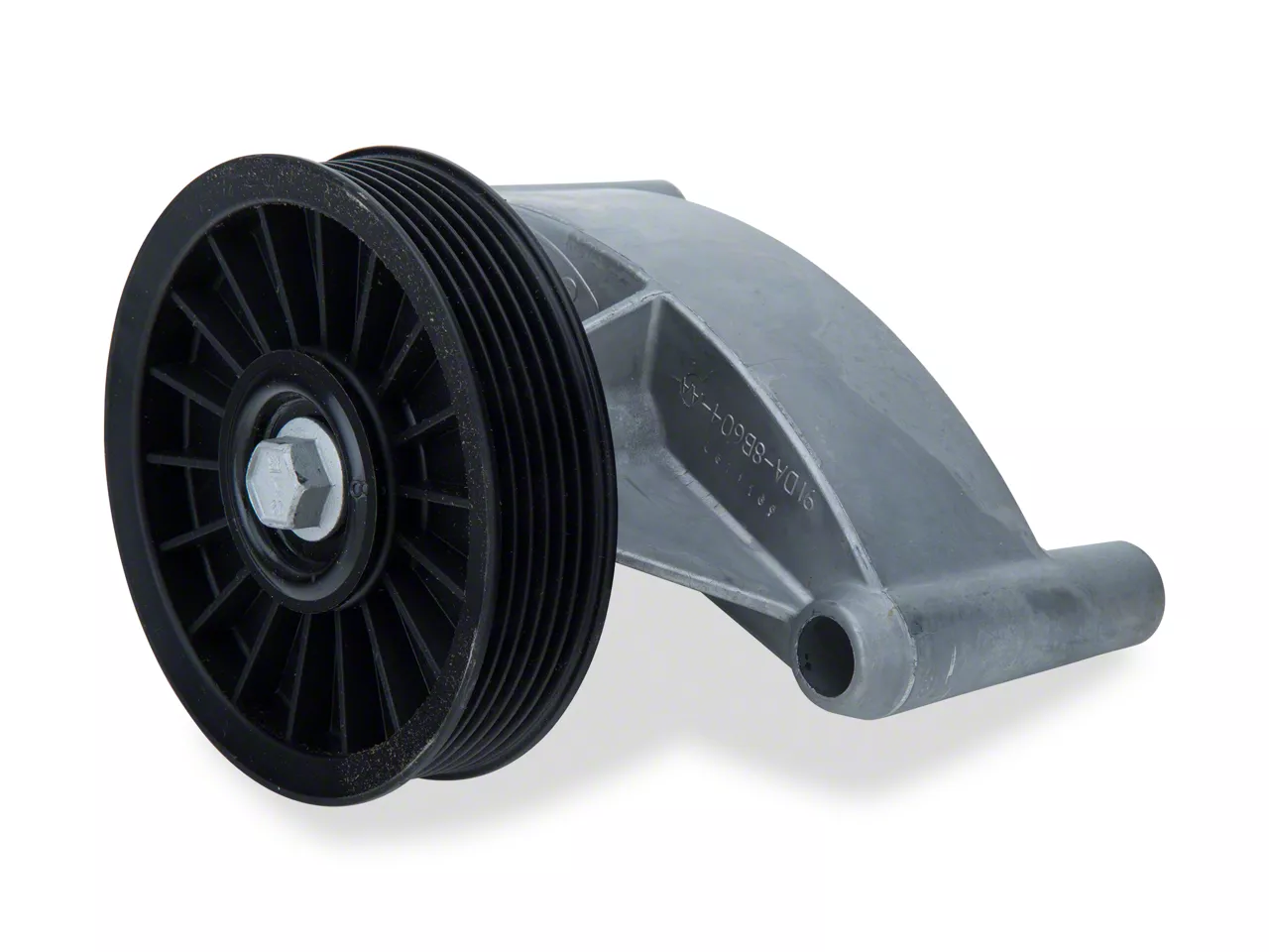

            I had that bouncing belt issue on my 87 when I first put a compressor on it. I ended up putting a smog pump back onto it just to get the belt to not bounce around or come off. It threw the old belt a few times before I did that. Hopefully you have better luck and can leave the smog pump off.
              No, I tried one on my 85 and it didn’t work.
                I've got an underdrive pulley on mine with no smog pump, and the belt works fine. There isn't a lot of room between the to and from sides but despite winding it out pretty far more than once it has never chucked or eaten a belt. Can't say why your car might not be working, but if its throwing belts I'd be looking at the pulley alignment and for bent or loose brackets. That long smog pump bolt that goes through the plate where the tensioner is probably ought to get re-installed with a piece of pipe to make up the distance of the missing pump. Stock there is a spacer behind the pump, just measure the length of that plus the pump and cut a piece of pipe to that size. Without the bolt (and mine is missing) the bottom of that bracket is not really supported by anything so it could be out of position.
