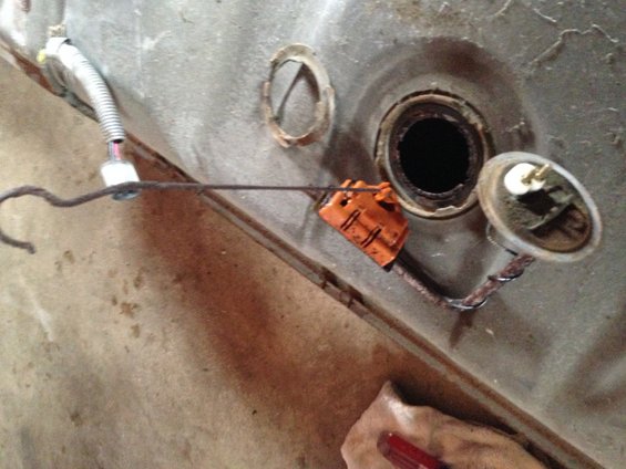

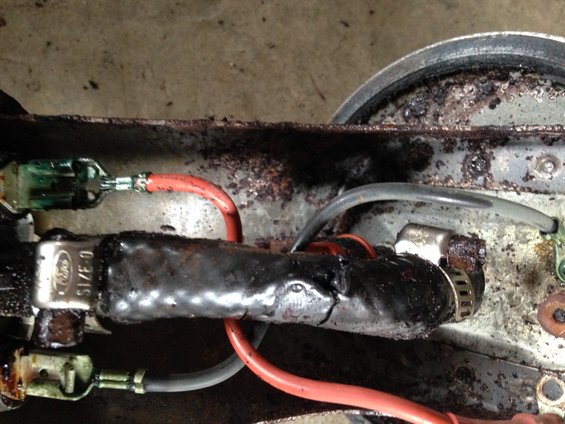

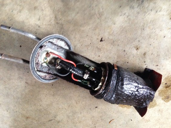

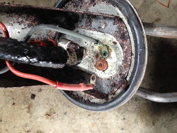

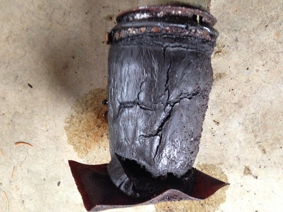

    Did some probing around on the fuel system today. Fuel filter was clean. Fuel lines are clean. Fuel pump officially locked up so it never pumped nasty rust chunky fuel (at least not much if it did).
    Got to figure out what to do for a new fuel pump. I have a new pump. But no rubber isolator (whatever that thing is around the pump) or strainer. Do I need the rubber thing? And the hot wire on the pump is unattached at the bracket. I guess I could solder it on? Ideas welcome! I don't really want to pay $100 for a new hanger/pump if I can use this new pump I have. Yes I am a cheapskate.
    Did some research on part numbers. This may affect some of you if you do a fuel tank on a car that's got a trashed fuel system like mine. All of these part numbers work for CFI or EFI cars - some are different for carb'd cars.
    E1AZ-9072-B is the fuel tank filler pipe gasket on the tank side. The replacement parts (Dorman) catalogs list this part as the same on a Box Panther and similar age Mustang. They are not the same - you need a NOS one with this part number.
    E1FZ-9B076-B is the seal for the fuel vapor separator valve on the top of the tank. It's common to all Ford cars of a similar vintage.
    E1VZ-9417-B is the seal for the fuel pump if you don't need the retainer ring and are too cheap to buy a new pump with one included (like me).
    C0AZ-9276-A is the fuel level sending unit seal. Common to most Ford products 1960-1990ish.
    C0AZ-9202-B is the float for the fuel level sending unit. Common to most Ford products 1960-1990ish.
    E3VZ-9B357-A is a fuel pump noise reduction kit that contains everything needed to replace a fuel pump except the fuel pump. This includes the rubber isolator that surrounds the pump.

    Tiggie...when i replaced my fuel sending unit it was the metal cylinder one. A piece of wire partially wrapped around it to clip it into place exactly like you have pictured.

    I did a fuel pump on a car that had been sitting for 9 years and it didn't look that bad. Holy cow!

    That is the worst I have ever seen. Yuck!

    Pulled the pump and sender out today.
    I'm not convinced this pump has pumped anything in the last several years. This would be a good thing since hopefully none of the crud got up to the fuel rails.
    Going to test the resistance on the sender next to see if it can be made to be functional again. See the lack of a float? Yeah it came out that way... and there was no float in the tank. Nothing has ever been screwed around with on this car, so I am guessing the stale fuel ate it. Yummy.
