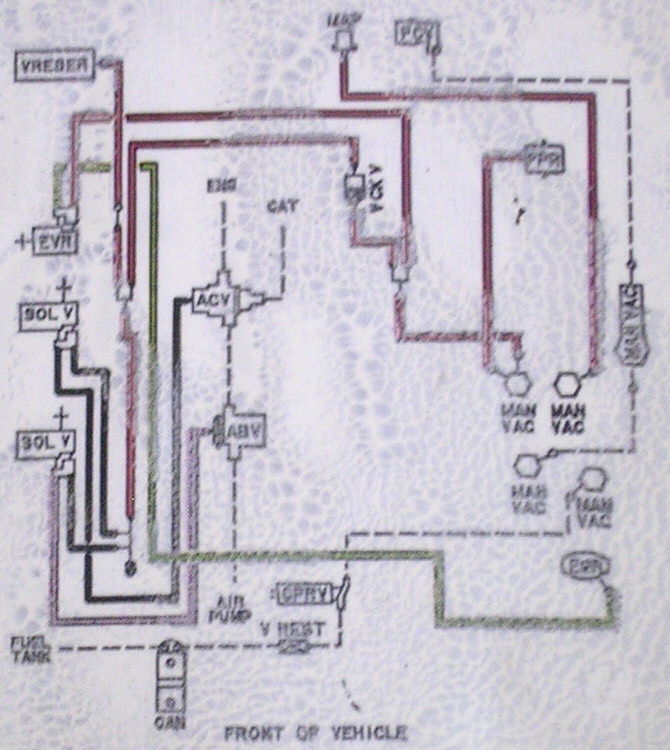

          sO, YOU'RE TELLING ME there shold be a vacuum on the red line going to the manifold and no vacuum going on the green line right?
          Originally posted by slack View Post
          Just did a quick search and found the vacuum diagram Sly posted from his 88 which should be the same...
          It looks to me that the red comes from the manifold to the EVR and then it's green from the EVR to the EGR? I'm pretty sure where the red line trees before the EVR is what I bypassed.

            at idle... yes. There may be a little pulse on the green line, but not enough to pull the EGR open.
              Yeah right now I have a little pulse at idle on the egr vacuum line.
