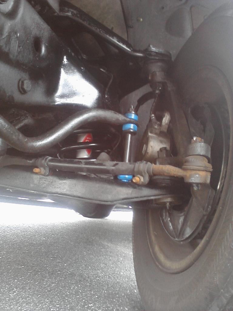

    So with pushing the control arm bushings project back to late summer (hopefully). I figured I would get the other front suspension stuff done now as it's almost dangerous to drive on bad roads. The front end suspension basically bounces around like a dolphin in the water.
    I ordered new heavy duty Mevotech stabilizer link bars, Moog upper and lower ball joints, heavy duty Moog springs and KGY gas-a-just shocks for the front of the car.

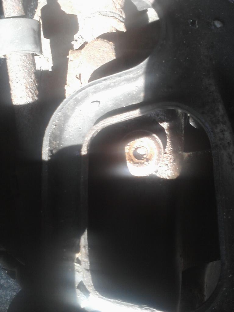

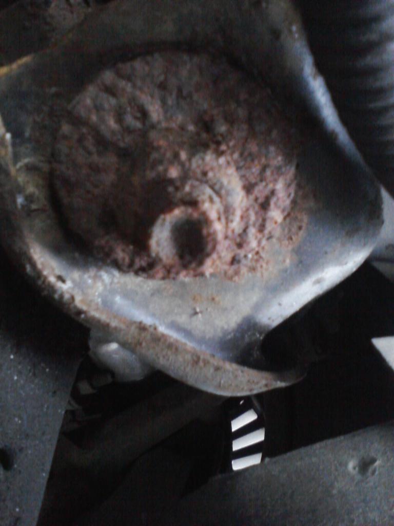

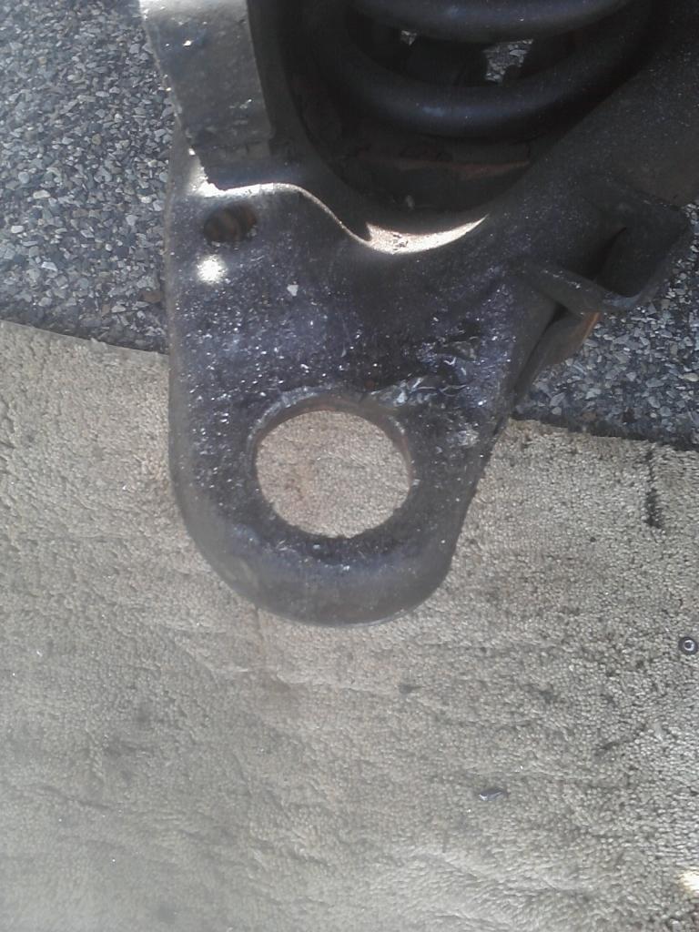

                    Side note. I tried to take a pic of my upper control arm bushings. As you can see, they're pretty cracked and the nut is rusted. No bueno.
                    Cracked rubber:
                    Nut:

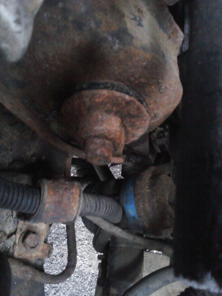

                    Aaaaaaaaaaaand while I had the hood open, I noticed that I had some coolant dripping from the bottom of the passenger's side radiator tray. Awesome. Upper hose is new and good. No wetness up there. I'm thinking the radiator is now probably busted. :\

                      mmm crusty.
                      As far as rust paint I cannot say. I have no luck with rust. This last go around I am just going all out with eastwood products. I suggest looking for reviews on line and on youtube before purchasing anything. This is how I fell upon the eastwood stuff.
                        #71
                        They look like mine when they came out. Surprisingly after 2 months of soaking them with Kroil, they broke free.
                          Packman
                          Oh thank god. So there's hope I'll be able to get these things off!

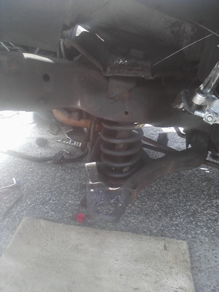

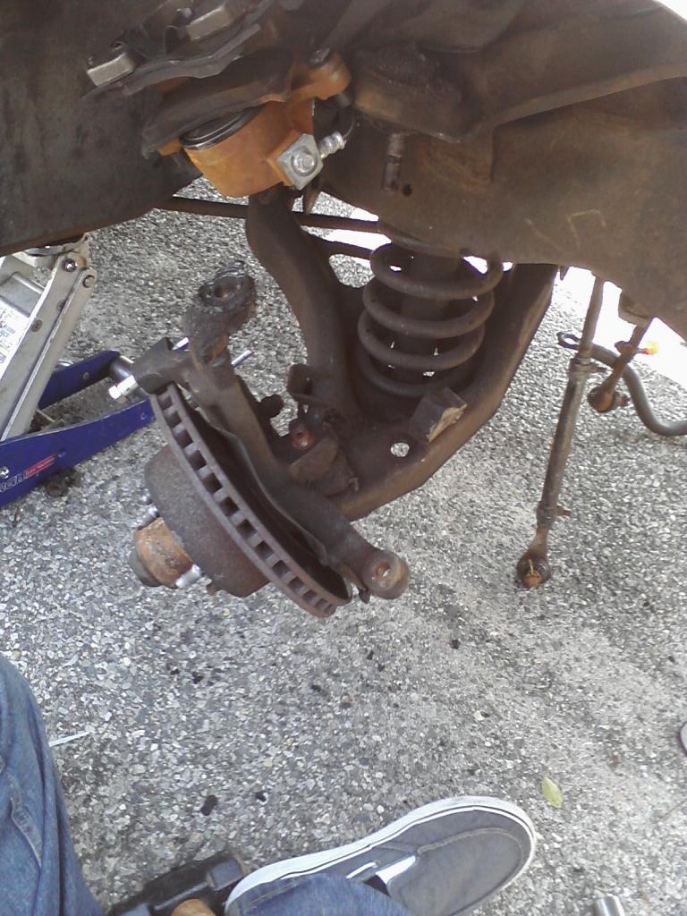

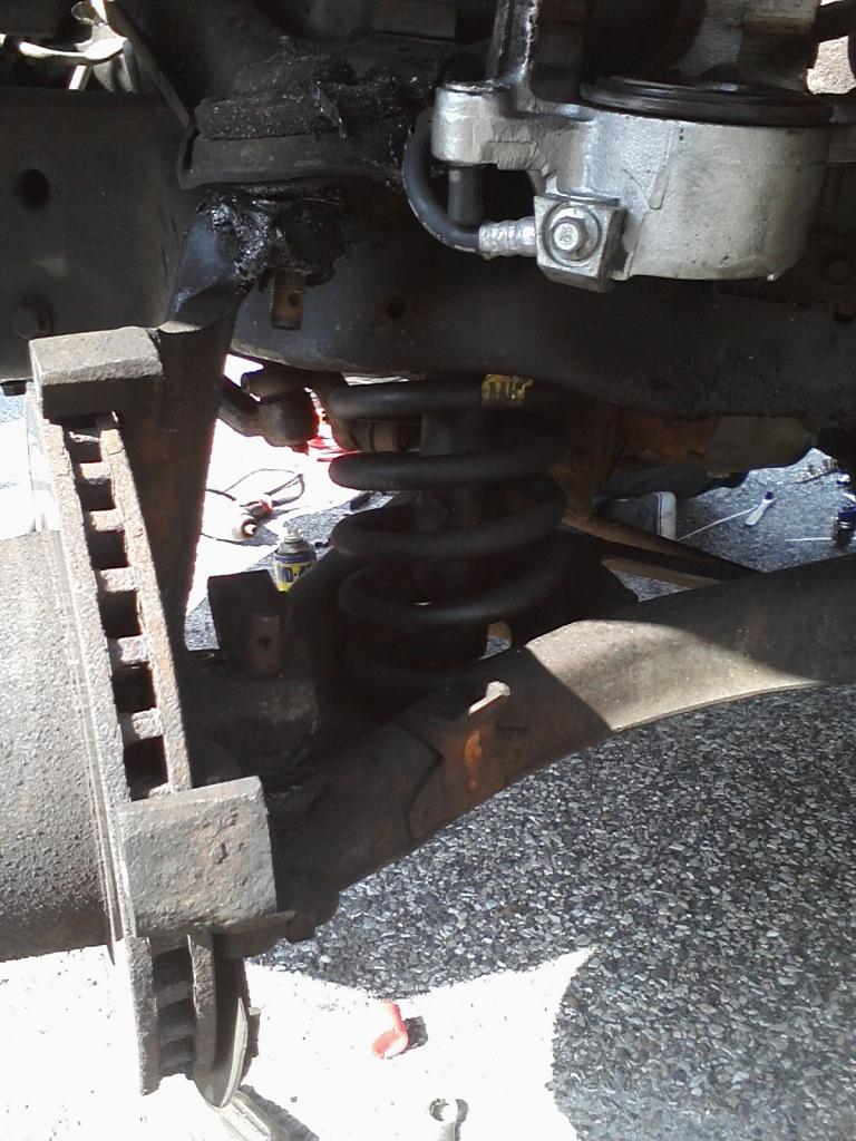

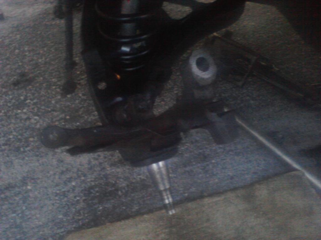

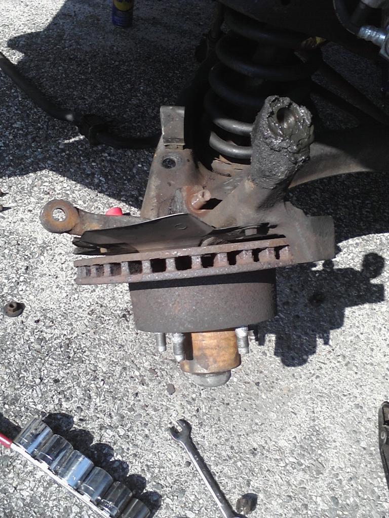

                            Lots of work done yesterday. After 13 hours on Sunday my friend and I were able to replace my shocks, springs, upper ball joints, lower ball joints, sway bar bushings, stabilizer links, rotors and inner and outer wheel bearings. (Basically what wasn't already previously replaced of my front end last time. )
                            I used the HD coils. A word of warning on those, they take A LOT to get them compressed enough. For a moment we were unsure if they were even going to fit in the car. The ride is super firm now but not harsh. I like it.
                            Anyway, on with the pics!
                            Here's more or less what we started with:
                            Detached the sway bar as well as the outer tie rods.
                            Disconnected the upper ball joint. Careful with these, they spring out like it's trying to punch you.
                            Upper ball joints were original so the rivets needed to be drilled out. This was a pain in the ass and in the end required a decent amount of prying.
                            Out:
                            Here is the hub about to be taken off the control arms: (Note: The rotor makes it impossible to get out with it still on. You have to take it off first)
                            Pressed out the lower balljoints with the tool rented from AutoZone:
                            Another shot of the of everything but the coils and shocks removed:
                            ...More pics to come.

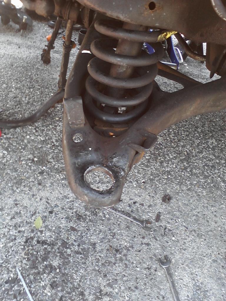

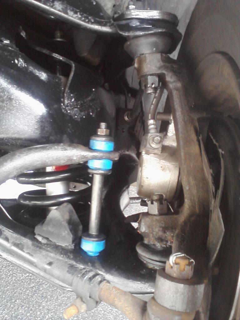

                              Lower ball joint hole after pressing out:
                              I used the method stated in other threads about getting the shocks out. Basically put vicegrips on the shock and twist the screw until the head snaps off. Worked like a charm! Here's looking down at the snapped bolt:
                              ...and here's the nut:

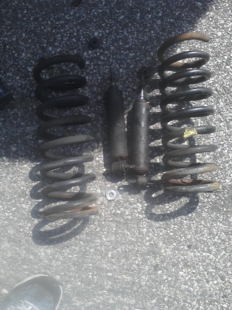

                              Here's the suspension stuff removed. The springs were still good but the shocks were toast.
                              We got everything out quicker than we expected so I decided to paint the inner wheel wells and control arms with some engine paint before we decided to reassemble. Came out okay considering it was a 10 min afterthought.
                              At this point I stopped really taking that many pics as we ran into issues with getting the springs in that ate up a lot of time as well as pressing the lower ball joints in became a headache.
                              Here's a pic of the new shocks and springs in:
                              Upper ball joint installed but not yet greased:

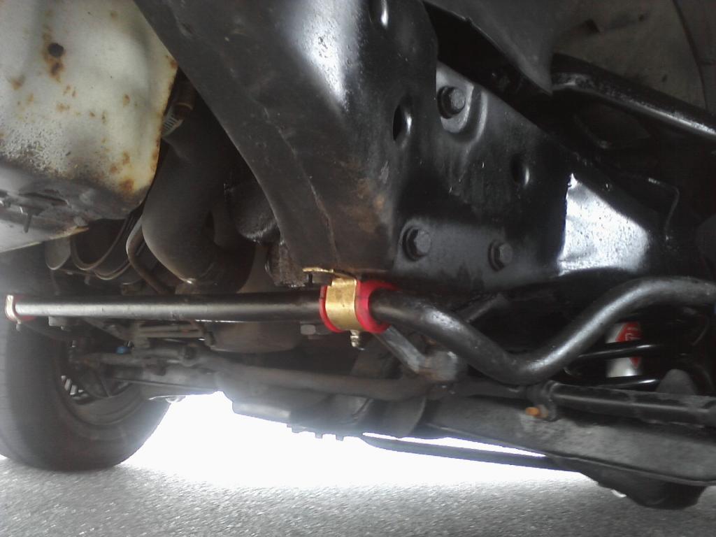

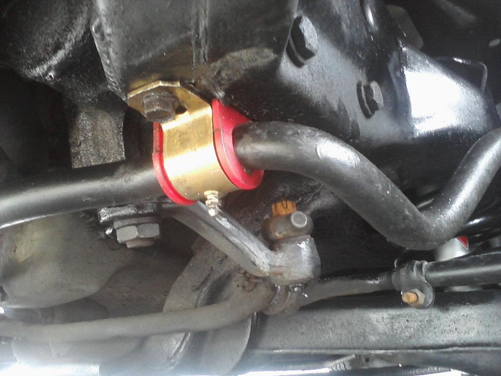

                                And here's some final pics of the finished job. We started at 9am and didn't get done cleaning up until 11:30pm. What a day!
                                A little run down of what wasn't pictured, after the coils were installed, we installed the shocks. After that we screwed in the new upper ball joints and then had to press in the lowers. (Headache, even with the tool...) After the lowers were installed it was new rotors with new inner and outer wheel bearings. Greased them up and installed. Then it was just a matter of connecting the outer tie rods, putting on the new bushings on the control arm and screwing in the stabilizer links. Finally... grease grease grease.
                                Energy suspension control arm bushing:
                                More:
