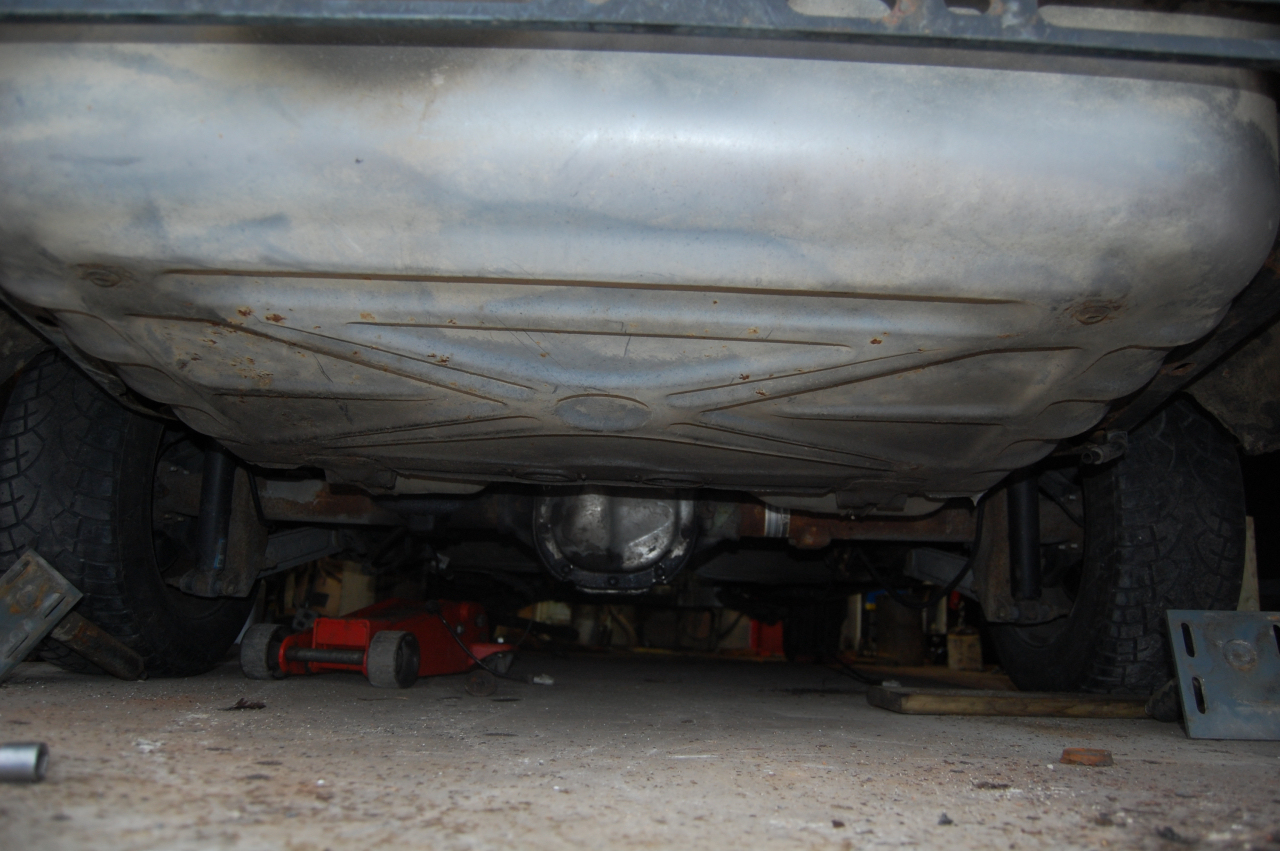

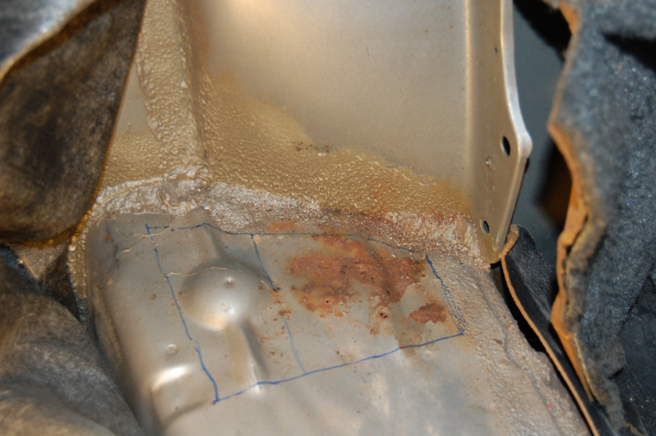

                Making slow progress tonight. Cut a hole in the trunk and snapped the last body mount bolt.
                Here is the bad spot. Turns out there is a channel underneath the trunk floor where water and dust can collect. There is actually a drain hole in the corner but mine was all clogged up with crap. No wonder it rusted.

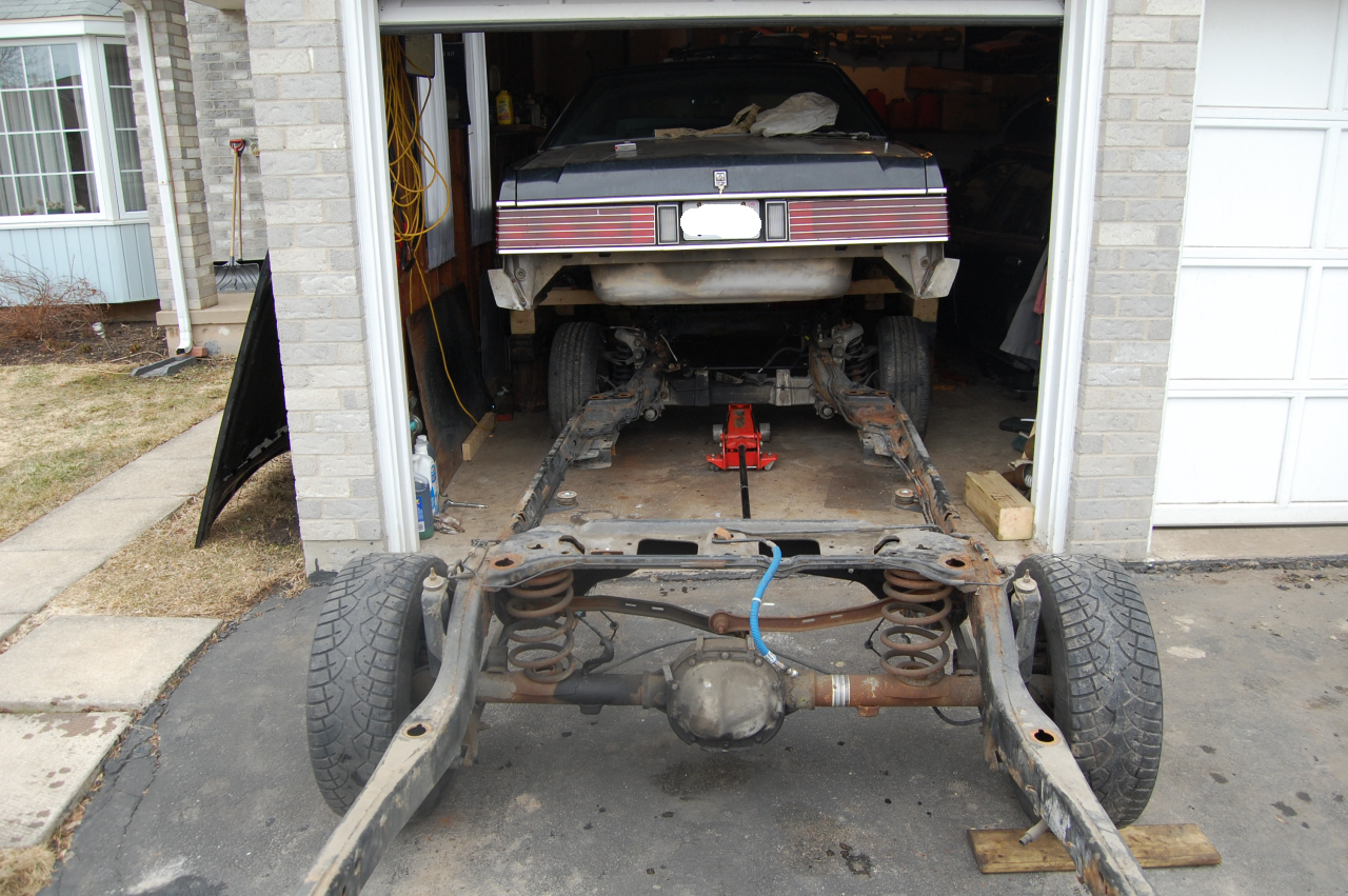

                I also did some more checking and measuring. Rear of the frame is exactly the same on box and whale. There are unused holes in the 07' frame that are being used on the 85'. Box rear bumper bolts right up to the 07' frame. They added an extra support to the 07' frame between the frame rails which is kinda nice actually. Makes it sturdier.
                If everything goes according to plan I am hoping to test fit the 07' frame tomorrow.
                Excellent news for those with rotted or bad frames. There's more aeros/whales in the junkyards than boxes I see.

                  I had to rebuild that entire area on each side in my car. Good you are finding this now.

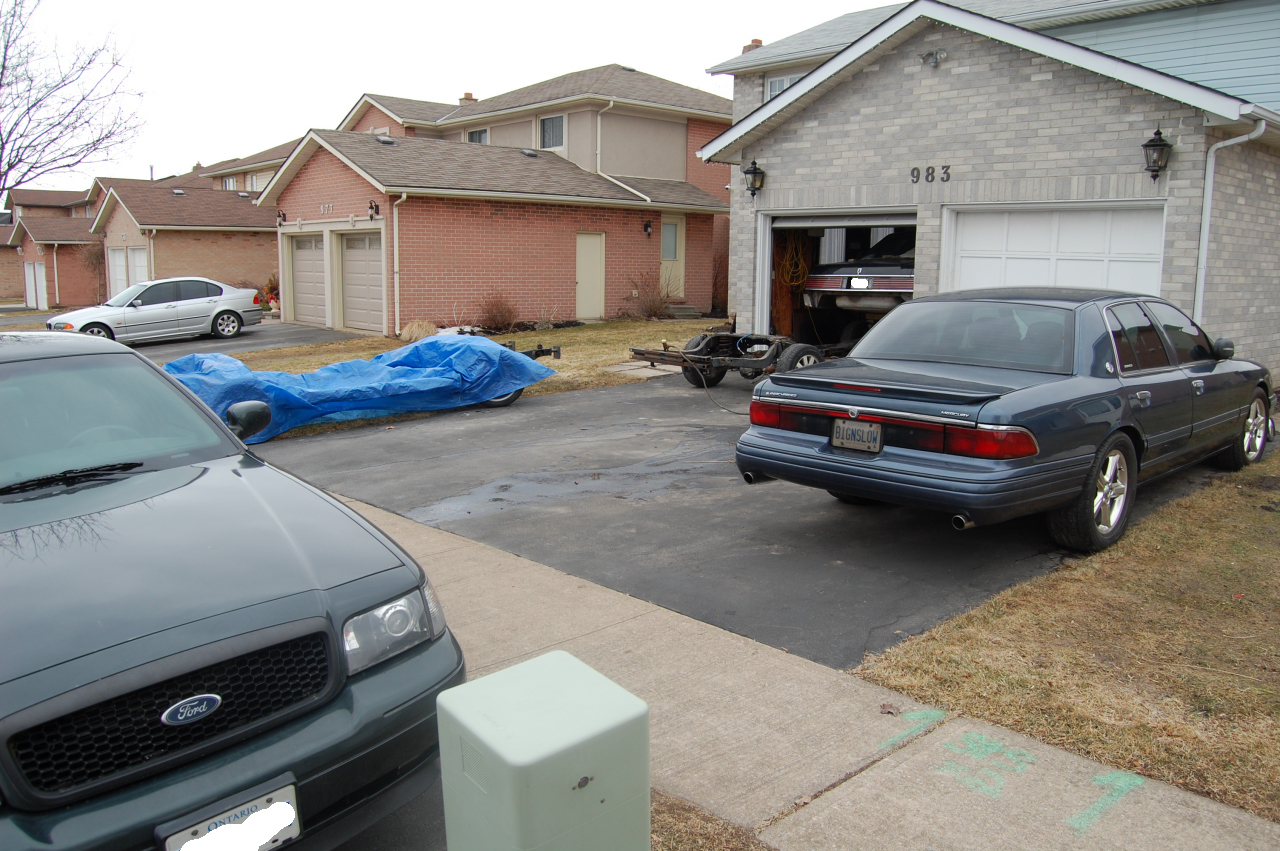

                      The time has come. Place your bets on whether or not it will simply bolt on.

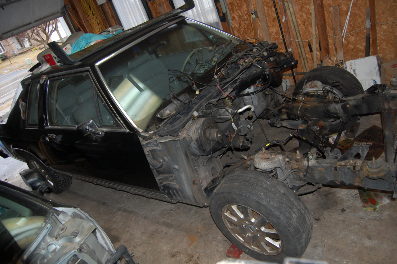

                              Ah screw it. Here it is. Bolts right on, zero mods this far.
                              So knowing this the 03+ frame is a direct swap for 98-02 and will also be a direct swap for 92-97 with minor mods to the header panel. As far as 79-92 go the frame itself bolts right on. Will let you know tomorrow what's needed to get the nose installed.
                                That's awesome. And also tells you how much Ford has changed the platform over the years.....
