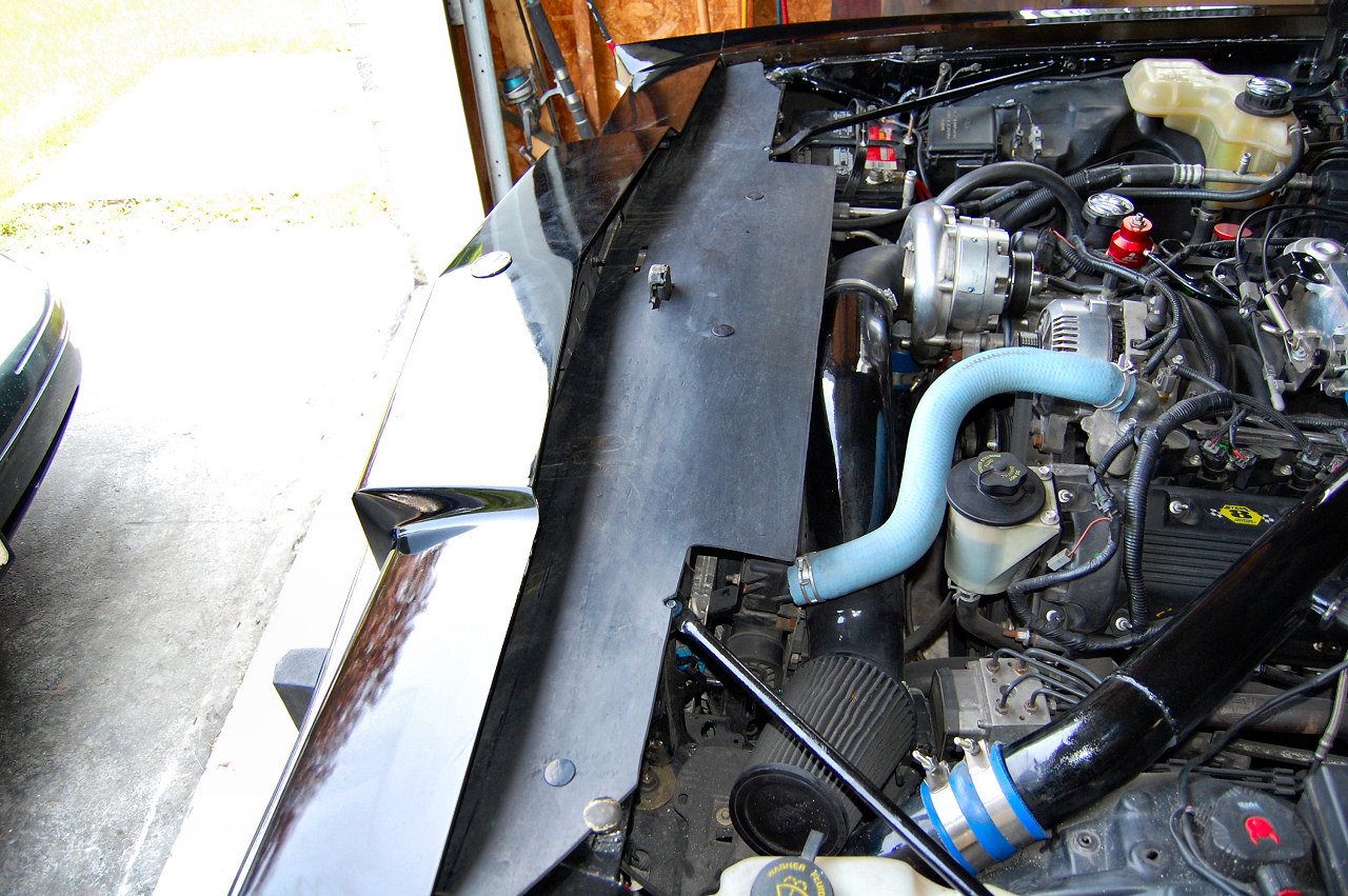

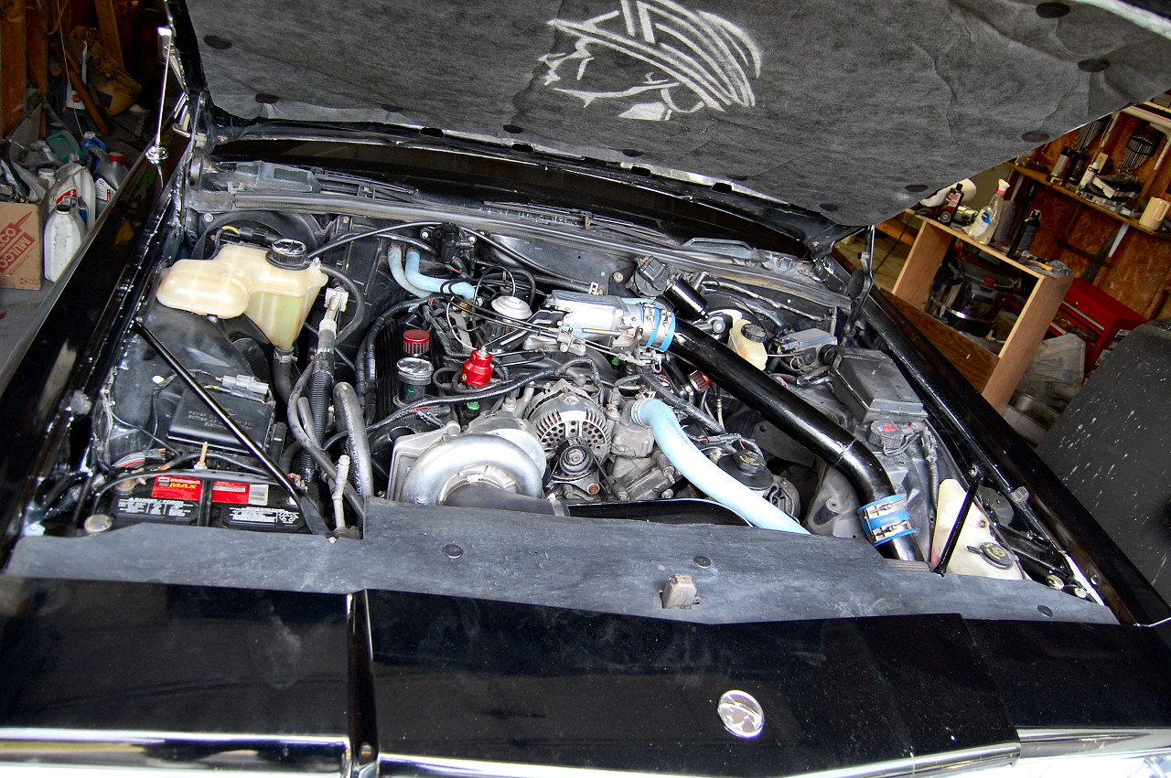

          Today's little project was this under hood cover in front of the rad to mimic what they have on the newer cars. This should also help direct some of the air into the rad and intercooler.
          I used a large piece of rubber that I had laying around. Don't ask me where to get it, I have no idea. I pulled it out of the trunk of my Caprice when I had it. I think it might be used for tractor trailer mud flaps. Also, I am aware that the push pins are not symmetric but nothing I can do about that, just using factory holes in the rad support.
            Cool. I have always though about meshing two covers together from an aero/whale to fit on my car. Never got around to doing it. Would have cut for a center section then two side peices with the center section overlapping the sides.
              I originally had your idea of cutting up 2 sections of whale cover. I actually ended up cutting one of them then test fitting it in there only to realize that it won't allow the hood to close. Making one of sheet plastic, aluminum or carbon fiber might work out nicely.
                Thats sort of something I've been meaning to do on my own car. I'd be doing it for use as a tool tray more than anything else. I get real tired of having things drop into the abyss. I've got an extra foot up there vs what you guys have, so really large things fall through the hole. Mercifully they tend to just hit the floor instead of hanging up on the rad support. I think I'd need to make some little brackets on the header panel end to work as supports. Probably nothing more complex than an L bracket screwed under where the front weather strip piece is to let the panel sit on.
                  Thanks for the heads up. Looks like something I will no longer pursue.
                  Real quick though...Wouldn't close even with notches cut out for the rad hold downs and fender braces?
                    Yup. The plastic piece just sits too high with all the bulges in it. If it was a flat piece of plastic then it will work.
                      makes me wonder if the aero cover would work.
                        I think you would have the same issue.
