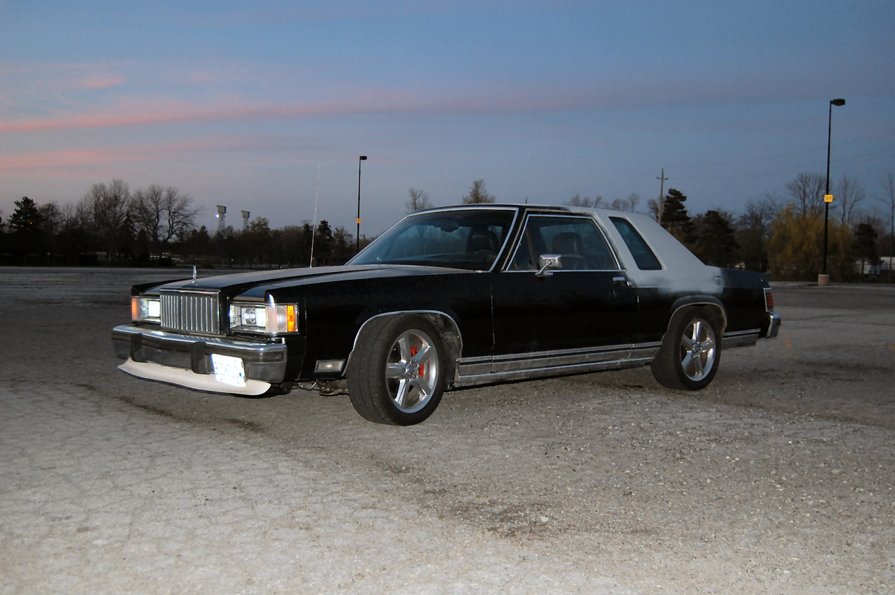

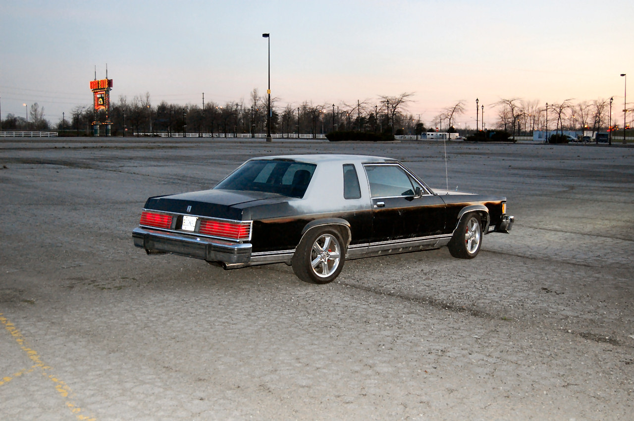

                    First pics of the car out in the wild.
                      Got any driving clips? Also, do people give you weird looks when they hear it take off?
                      2003 Crown Vic HPP- 3.27s. Dual exhaust. 11.25" torque converter, Arnott Limo Duty HPP-rate rear air springs. 205,xxx miles. (Stolen by the old man)
                      1995 Impala SS- 28,293 miles. The Lovely Lady
                      2003 BMW 325i- 113,xxx miles. KYB ZHP(M)-spec struts, Rear M3 shocks, Exhaust butterfly valve delete, USB and Bluetooth playback with stock head unit, Projector Retrofitted lights, Euro-convex mirrors, slotted-not drilled rotors all around.
                        I was getting looks all day driving around. On the way to work this morning some old guy in a minivan almost came to a stop going the other way. Stared at me then gave me a thumbs up. I laughed.
                        I will get some videos once the car is completely finished.
                          The small line on the filler neck could be plugged into the vent directly with no check valve and it would vent normally during fill up. I have no clue how that plumbing works to go to the evap stuff. I can look at my 00-04 EVTM when I get a chance and figure it out.
                            Also, you can get the window channel weather stripping from JC Whitney. I don't remember the part number, but it comes by the roll.
                              I don't know how I feel about that front valence... What tires are those? Size wise.
                              Does it boogey?
                                Does it boogey?
                                I have mixed feelings about the chin spoiler. I will know if if I like it once it's painted black. Tires are 255/50/18. This thing corners like a go kart.
