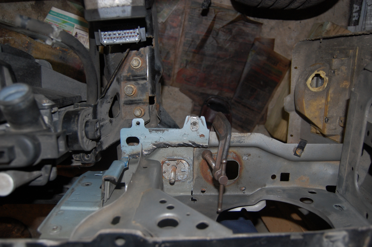

      Made some small progress in the last couple of days. Hacked up the 07' rad support and made some rough mounting plates for the 85' rad support. Gonna make them a bit nicer then weld it all together.
        Did some more work on the car today. Welded up the header panel so that's ready to be painted.

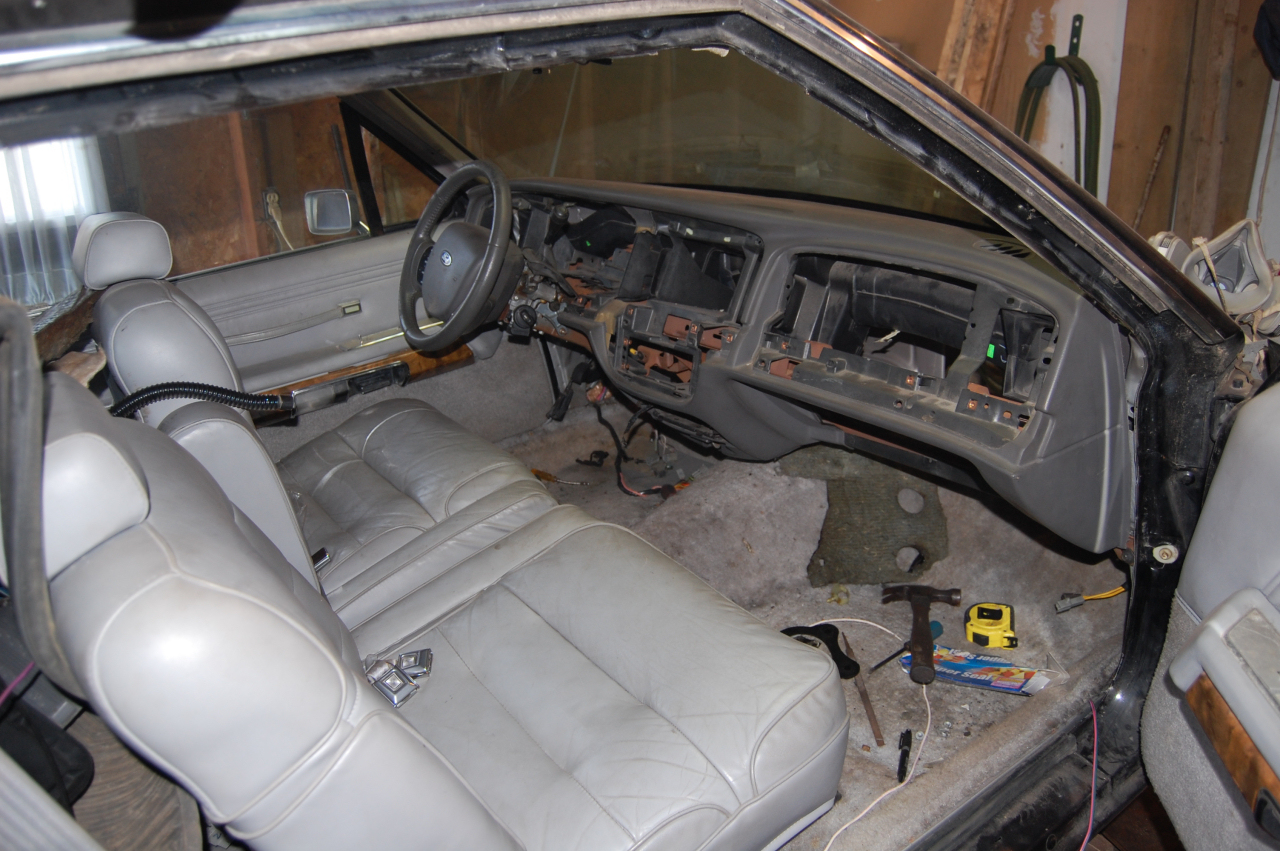

                Made some more progress today. Test fitted the whale heater and ac box which bolts right in. Dash also fits surprisingly well and lines up with the heater box. Might have to make a half inch spacer though or bring the dash closer to the firewall. Had to trim the metal dash frame a little on the driver side but otherwise went right in. Looks like I trimmed too much at the top so might have to find another dash skin at the junkyard. when it's all finished for better look.

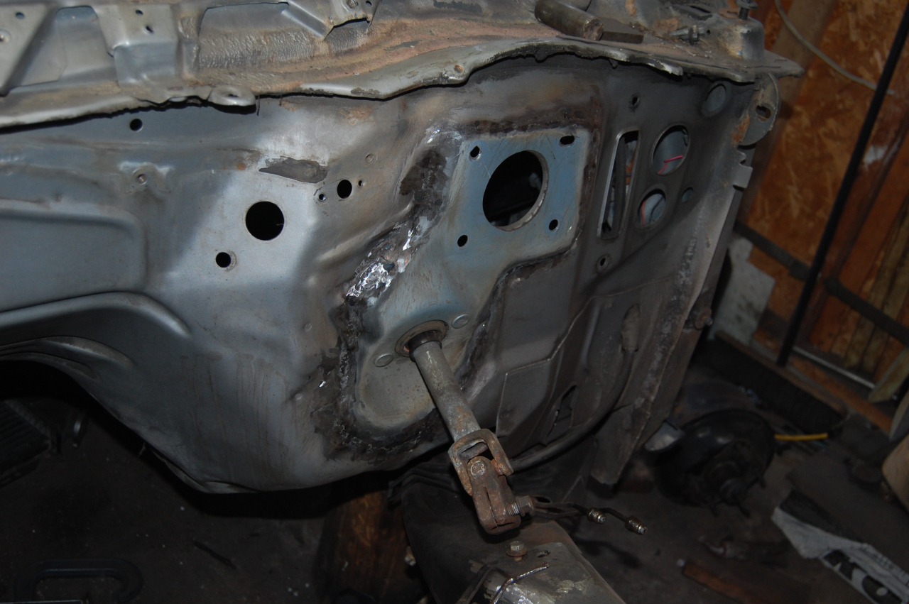

                Firewall will need to be modded for the whale steering shaft bearing. I hacked off a donor piece from the parts car so I should be able to make something that works.
                  Moving along slowly but surely. Welded up the firewall today to fit a Whale steering shaft.

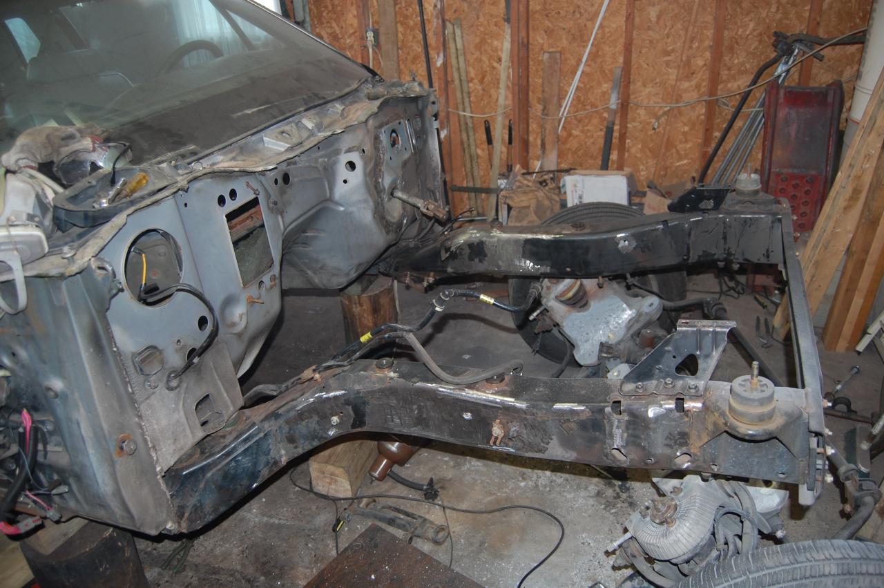

                  As it turns out Whale parking brake pedal bolts right onto the box like it was meant to be there. I also started prepping the frame by grinding away any rust. Still not sure what to use for coating. Been reading a lot of reviews on POR-15, Eastwood and Rust Bullet. Still not sure what I want to use but leaning towards POR-15.
                    Got a little more done today. I removed front suspension and started grinding all the rust off the frame. Sadly the 07' frame is not rust free like the 85' frame was. Plenty of surface rust to grind. I did both frame rails in front of the firewall.

                    Also, welded in a piece of 07' firewall with a correct steering shaft opening.
                    The 07' dash fits surprisingly well in there.
