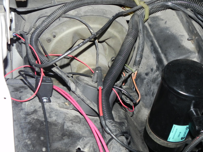

                              Relay mod done to AC blower. blows much gooder now. not quite twice as much... but damn near at least a third better.
                              the only tricky part was getting the trigger wire attached to the fat orange wire originally going to the blower. The wire into the harness actually slid out of the harness. made that one real easy to solder up.
                              me likes muchly.

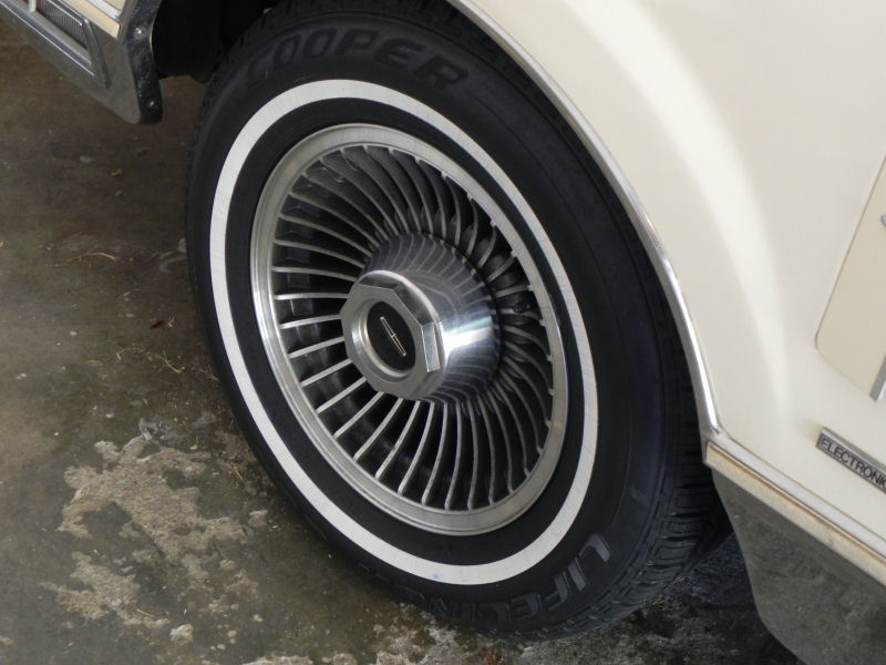

                                new meats on the Mark... vibration is all but gone up to 75mph now.
                                215/70/R15 Cooper tires. Very much better.
