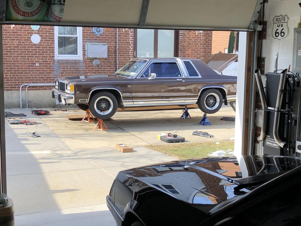

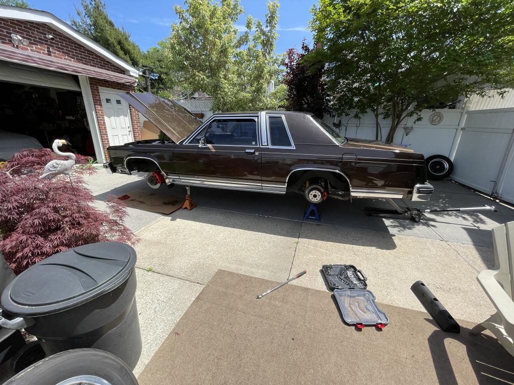

      Unseasonably warm here...Popped outside and jacked up the car.
      Measured angle of crank, driveshaft and then pinion.
      Got crank relation to driveshaft to .25 degrees. Ideal is zero acceptable is up to .50 degrees. I did this by adding a 1/8" shim I plasma cut up to go between the trans and the trans mount. I recently removed a tranny mount which set the tranny 1/4" lower.
      Got pinion angle to -2.50 degrees. Very little adjustment was needed on the upper rear arms and I am all set to go.

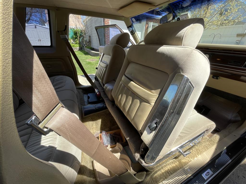

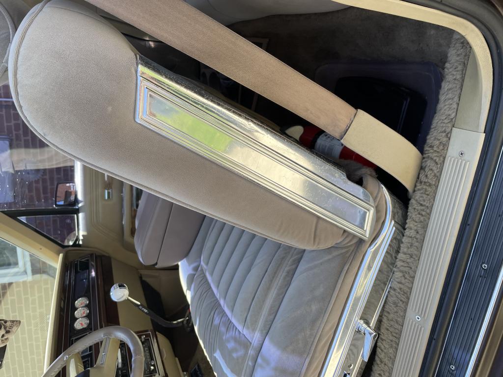

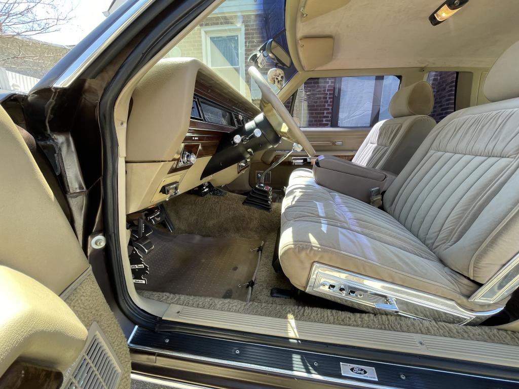

                  I added back the tilt forward seat levers.
                  I could not locate a set of two door hinges so I did what many recommended...using the welder.
                  While on a junkyard trip (in New Orleans....was there for work) I cut off a couple seat back tilt levers from a mid to late 90's mustang.
                  I welded on the little bits I cut off and then used the mustang knob as well. It works and I can get to the back seats easier now.

                    My clutch pedal was really loose and I did not know why. I mulled over it all winter expecting the welds broke that held the clutch pedal pivot tube in place on the pedal assembly which would require the entire pedal assembly to be removed. This would not be fun whatsoever so I just procrastinated over it.
                    Manned up yesterday and while I had the seat out I pulled the underdash carpeting and then to my amazement I found out that just the pedals nut was loose. This was such a relief.
                      if it works loose again, maybe a self-locking nut of some type would get it done.
                        The seat back levers look to be more sturdy than the originals. Maybe they will not bend and break. I also like the center arm rest/console from a Lincoln. I wish I could find a maroon one.
                        Don't those clips on the floor mats catch on your shoes ? You might remove the chrome piece on the top and keep them near by.
                          Glad to hear the clutch pedal was something simple like that. I had a similar experience with my GMQ recently. It was running like crap/hard to start. 1000 things went through my head as to what it could be. Once I had time to actually look, it was just a loose spark plug wire. Easy fixes are the best fixes.
                            Absolutely will try that out. I have a clutch pedal height adjuster kit installed so I will have to see if I have enough threads left to fit a lock washer if things come to that.

                            I have you in my thoughts for when I go out to the yards for a maroon set (grabbing any set really in decent shape) as they are just too damn cool.
                            I have no experience with the original seat tilt levers. I can only hope these dont break off.

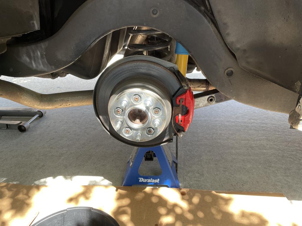

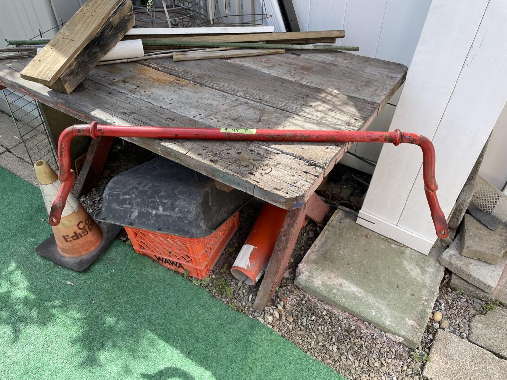

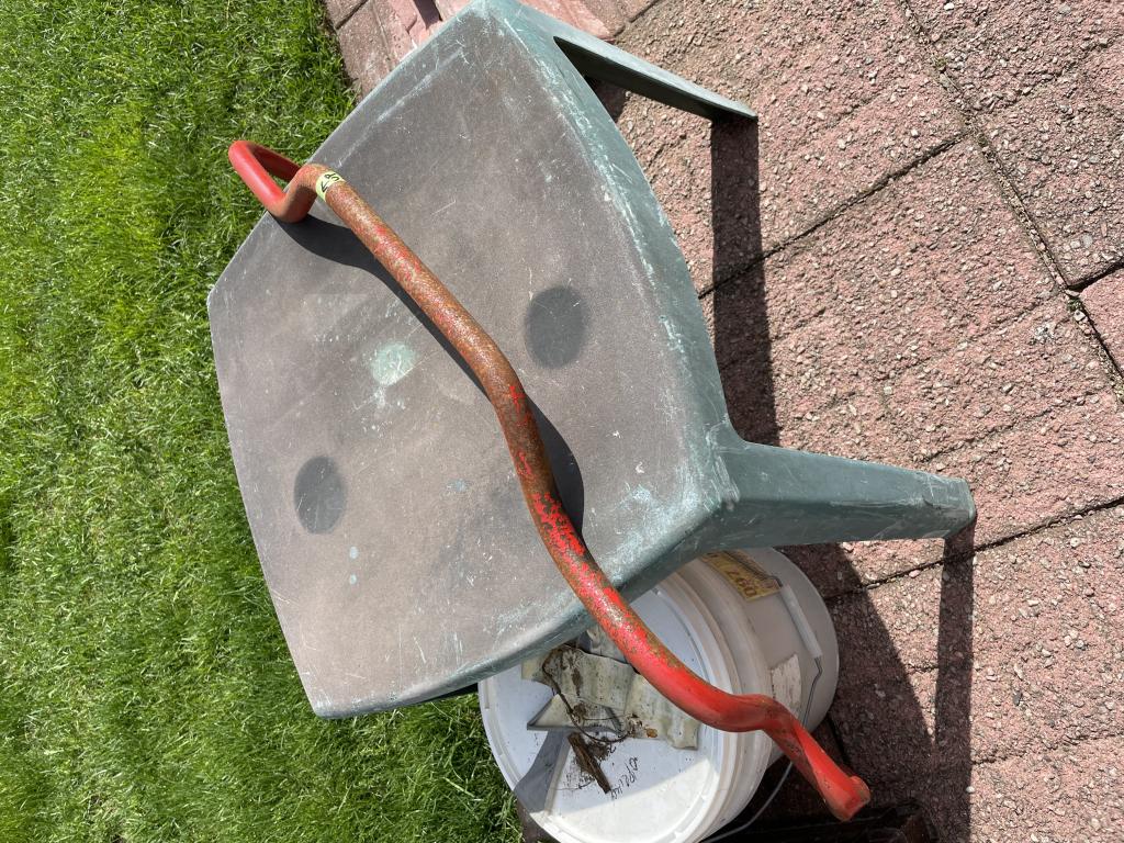

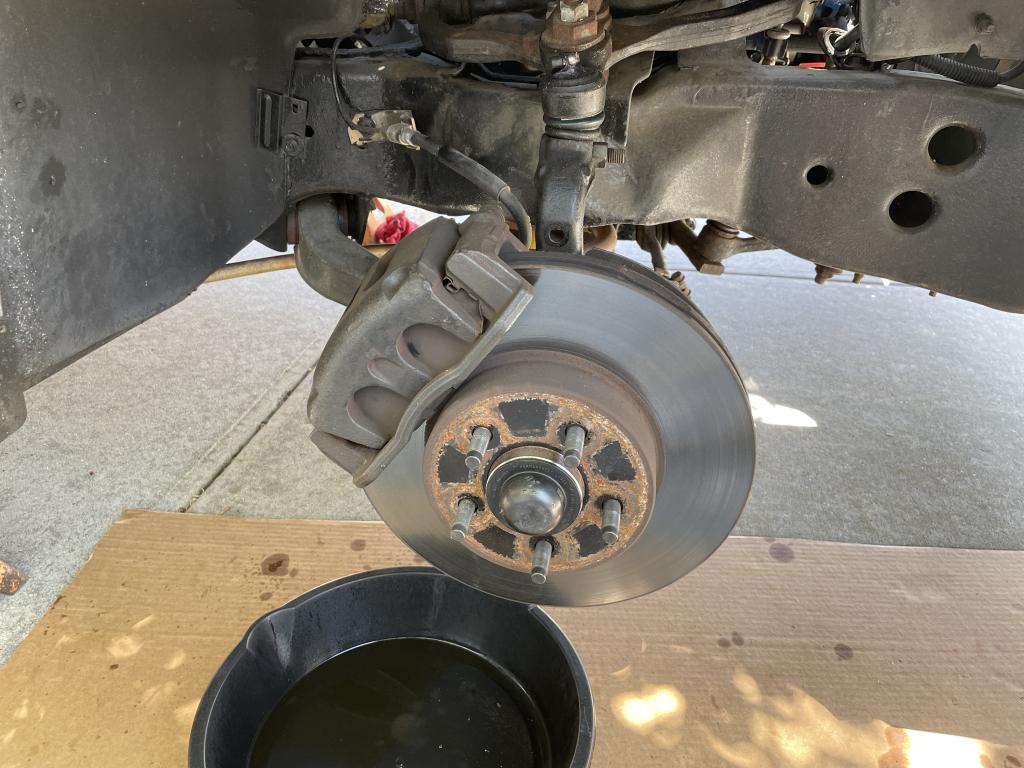

                                Jacked the car up, took off the sway bars (so I can strip them and repaint them with real paint this time...2k primer and paint) and swapped on my powder coated front and rear calipers. Once the bars are painted I will swap on the LX sport wheels and drive in style.
                                Super happy. Fronts were purchased powdercoated and the rears I did myself.
                                Front bar:
                                Rear bar
                                They didnt last. They were painted with duplicolor engine paint some years back.
                                BTW...super unstable with no sway bars on the car.
                                MVP of the day is my harbor freight HOLT vacuum brake bleeder. Second time I used it, first was back a few weeks helping a friend on with his 87 mustang gt. It works damn good when you are all alone and have no one to play the pedals for you.
