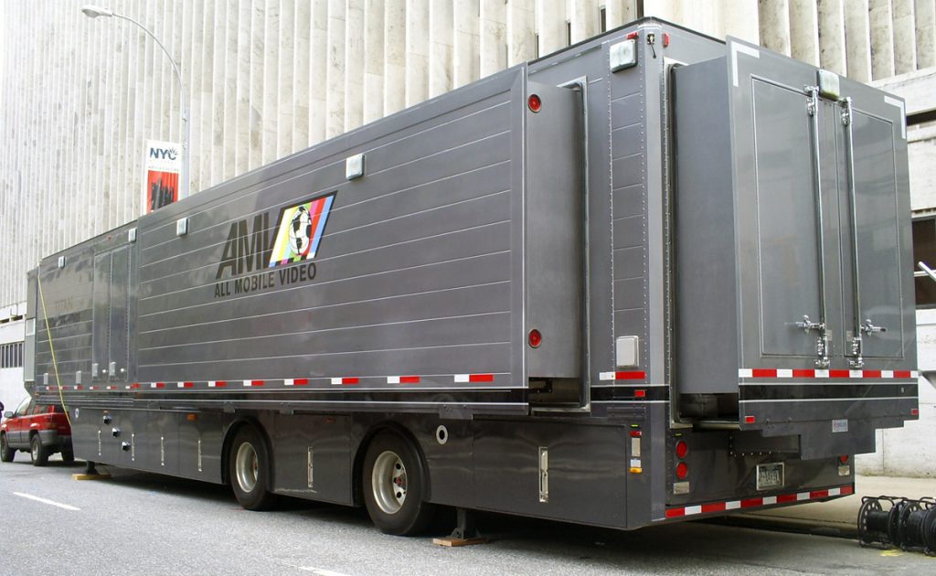

          ..what's inside that trailer? I saw some pretty sweet surveillance vans in scrap yards before, can only imagine how sweet that thing might be inside...
          That particular trailer is named TITAN.
          59’ 4” Long Expando Body, HD production truck, Sony MVS 8000X Switcher, Sony HDC-3500V Cameras, RTS Adam Intercom Matrix 128 x 128 Ports, Studer Vista X audio console
          Audio room, production room, tape/evs room, engineering and video.Much more involved than a surveillance van.
            Oh yeah, that's pretty radical alright. You kids and your tech.

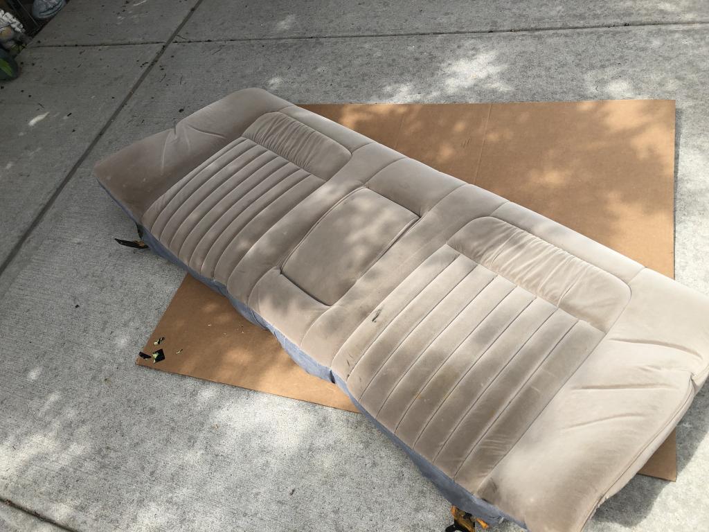

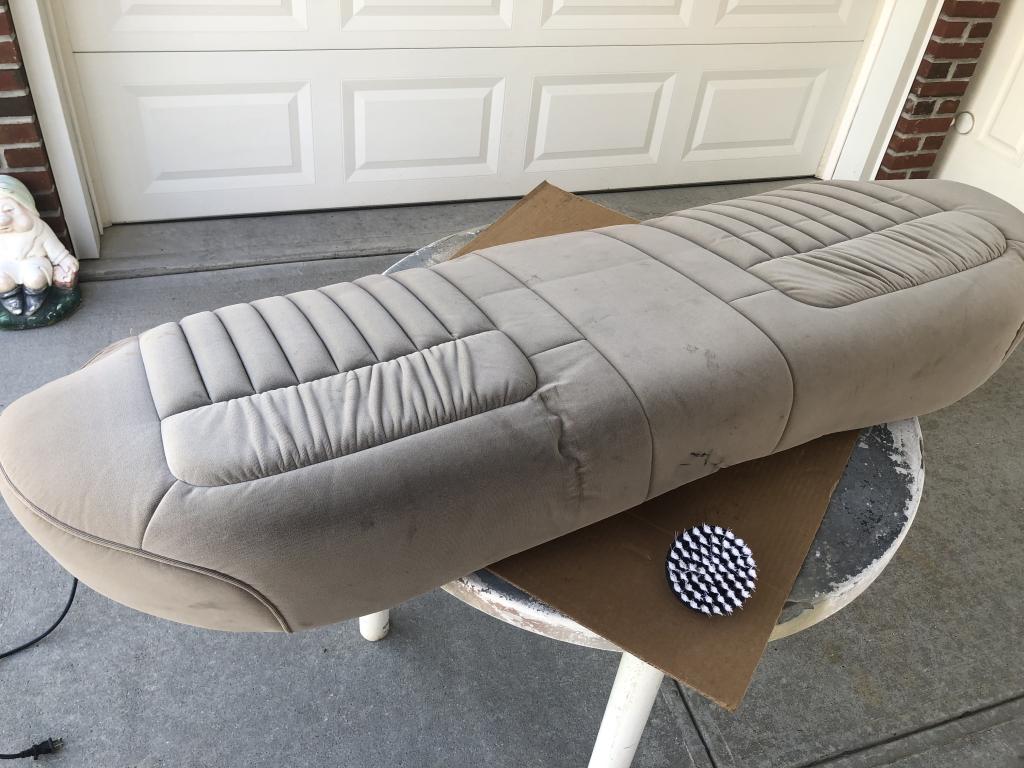

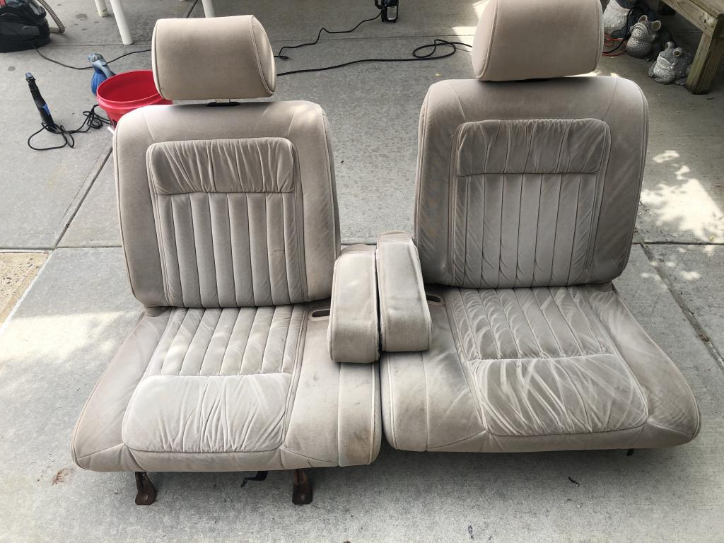

              Picked up some seats from Slack's 89 last week. They were complete, tear free and in the color I was looking for. SOLD SOLD SOLD...now the fun began of cleaning them and swapping on all the good bits from my seats.
              Before cleaning:

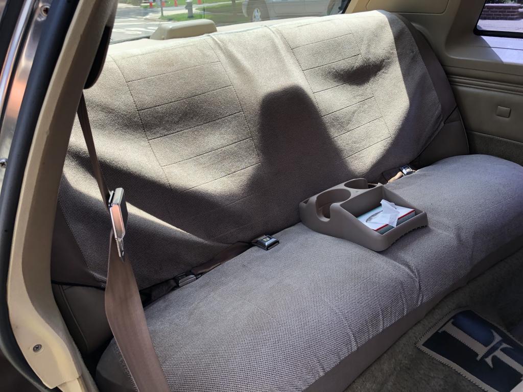

              This is what they are replacing:

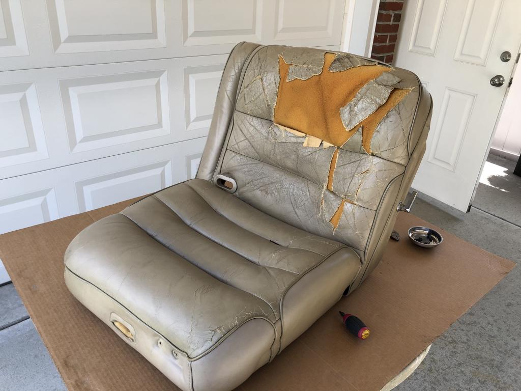

              Seat covers over my tearing leather seats.....it worked well for many many years...since at least 2008 or so but I wanted something better...stock looking...

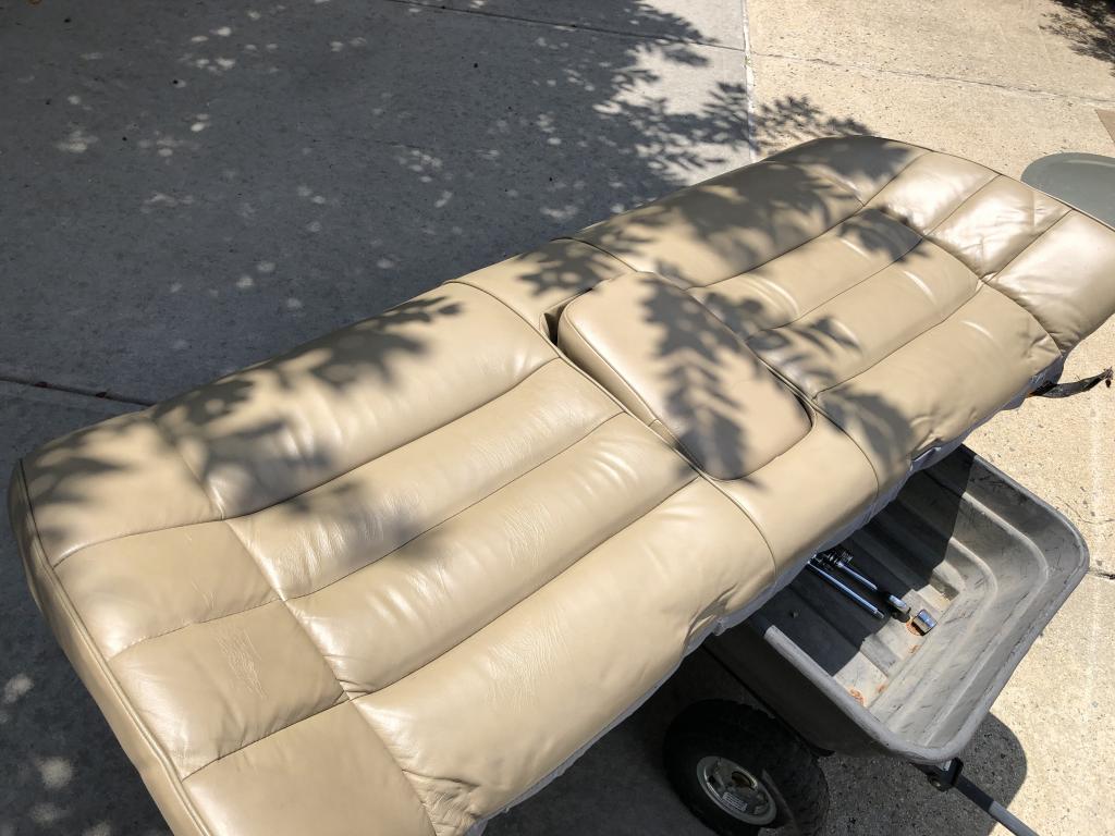

              These are what the covers are hiding:
              Drivers side:
              Passengers side:
              and rear:

              They cleaned up just fine using super clean, a drill brush, a steamer and a bissell spot cleaner professional. Quite happy.....
              Rear seats were a simple r and r.
              Passengers side seat I had to swap on my power seat track, swap the two door hinge on as well as swap on my fancy trim bits.
              Drivers side took 6 hours to swap over everything.... lol
              I ended up using my stock 87 seats upper and lower frame and installing the new to me covers onto them. My lower frame had a bunch of mounting provisions for "cassetter" and fire extinguisher mounts that I did not want to recreate. The upper frame was also straighter...the one from the 89 was bent backwards toward the passengers side of the seat. I also swapped over a thick piece of padding that was under my 87's lower seat foam...I also added some foam to the side of the 89's bolster from the 87 and shaved and glued it into place to help give it some life again on that side just above the power seat controls. Again, I am so happy with how everything turned out.

                              You went with your old armrests (covers?), any reason? Those armrests from slack's seats looked fine to me. Or are the armrests hard to remove from the top part fo the seat frame you mentioned?
