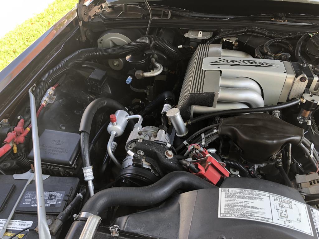

      This morning my dad and I installed all of the new ac components I have accumulated for the ac rebuild.
      List includes new hoses (3) new compressor, new receiver drier orifice tube and condenser.
      I flushed out the evaporator with a flush kit and after that was done we installed all of the new components as well as adding oil to the necessary ones and vacuumed out the system. It held near 30 inches of vacuum for over 30 minutes afterwards so we then started to add refrigerant.
      I added roughly 44 ounces of refrigerant. That coupled with the oil added brings the system up to 51 ounces total...That is if you take into account the oil...if not I would need to add more r 134a. Seems to be working okay. Vent temps just touch 40 degrees.
      I have to do some research to see if things are working correctly. I will say that the drier is getting VERY sweaty and so is one of the lines off of the compressor.
      See video for low and high pressure readings with compressor engaged and not engaged.
      I am just happy to be rid of the old leaky compressor and the ugly hoses.

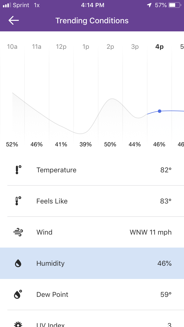

        Given almost humidity around 50% and a warm day, sweaty lines aren’t going to be uncommon. That’s par for the course down here. If they were icing up, then I’d be concerned.
        Pressure looks fairly normal as well for running at max cool if that’s what you had it at.
