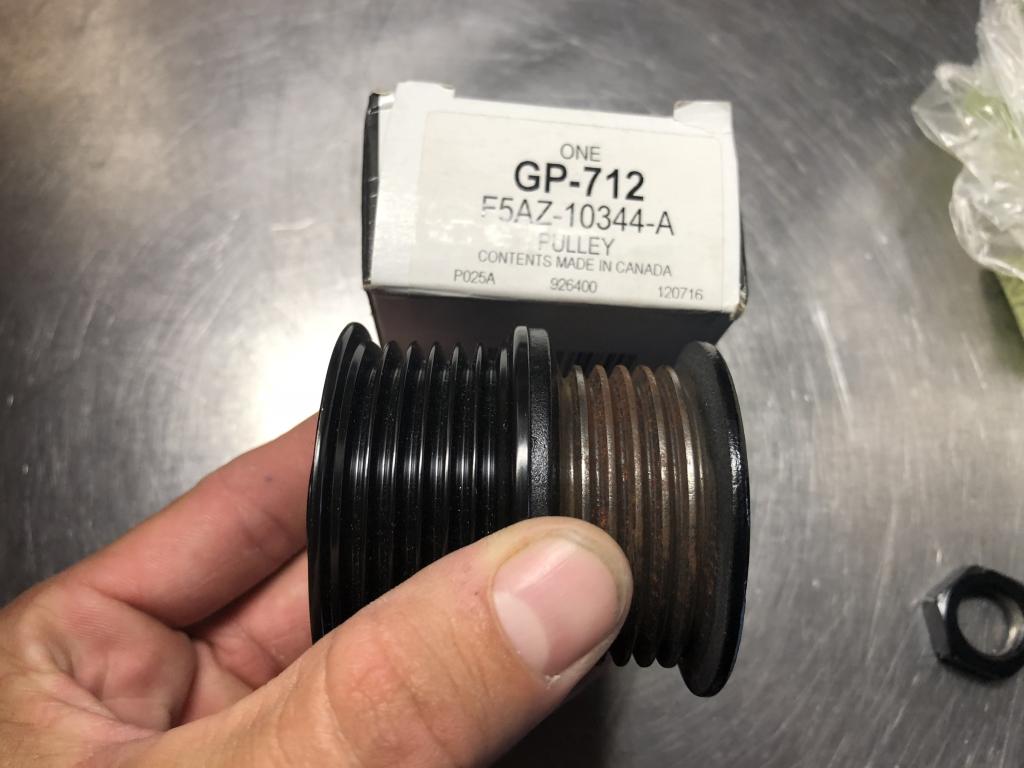

            An alternative option would be to pick up a 3G pulley for a '97 Ford Escort (Motorcraft GP-712). It's nearly identical in side to our stock 2G pulley. I have one I'm planning to use on my car once I get around to swapping in the 3G.

                So. Dad had an order for rock auto and it happened to have a shared shipper location so I picked up the pulley mentioned above and it is just a bit larger in size as compared to the stock 2g set up.
                3g on the left of screen and stock panther 2g on right:
                New GP-712 on left of screen and stock panther 2g on right:
                new GP-712 on left of screen and stock panther 2g on right:
                I haven't installed anything....winter project as nothing is urgent/necessary.
                  How's the depth on that pulley? Will it seat in the same position as the 3g/2g pulleys?
                    That pulley is the factory 3G pulley you would find on a 1997 Ford Escort. I know of at least one Mustang guy on another forum who is running that pulley without issue (that's where I got the idea).
                      Havent compared.
                      Sounds like it is exactly the same then as we expected. Will find out for sure once I bother doing anything about it.

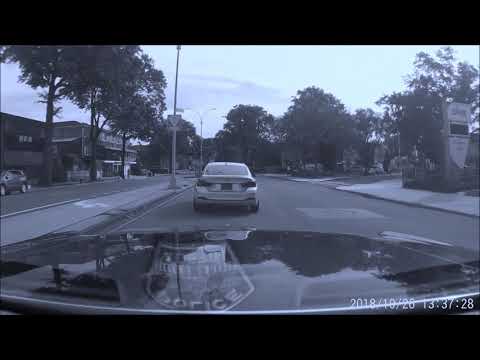

                        Put her away for the season....Not before taking it for one last spin. Compiled sound clips into a brief video from the dash cam.....Love that AOD whirring noise in first. lol
                            The AOD sound is so great that you should totally consider keeping it and selling me all your manual transmission conversion goodies haha.
                            You car does sound good especially in the mid range like when you passed an newish F150 in the video.
                              The AOD whine reminds me of school busses when I was a kid. Not sure what they used, but they were a very whiny and clunky automatic.
