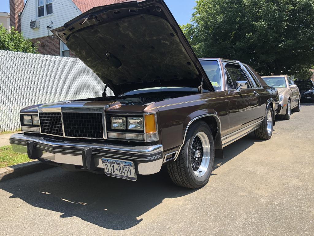

        Took her out this afternoon and this guy was excited to see the car:
          Don't lie, that was 4 years ago.
            Im lazy and dont reset the damn date and time.
              Where's your hood ornament?
                I have a delete ornament in place so the car cover does not interfere with it/damage the cover/damage the paint.

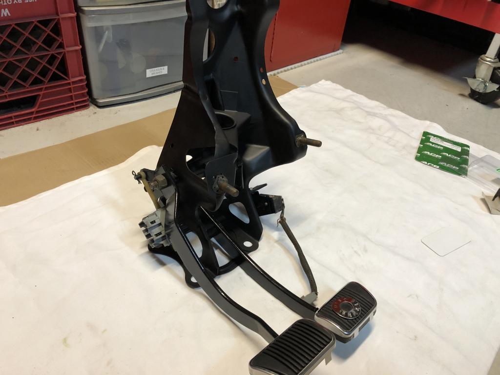

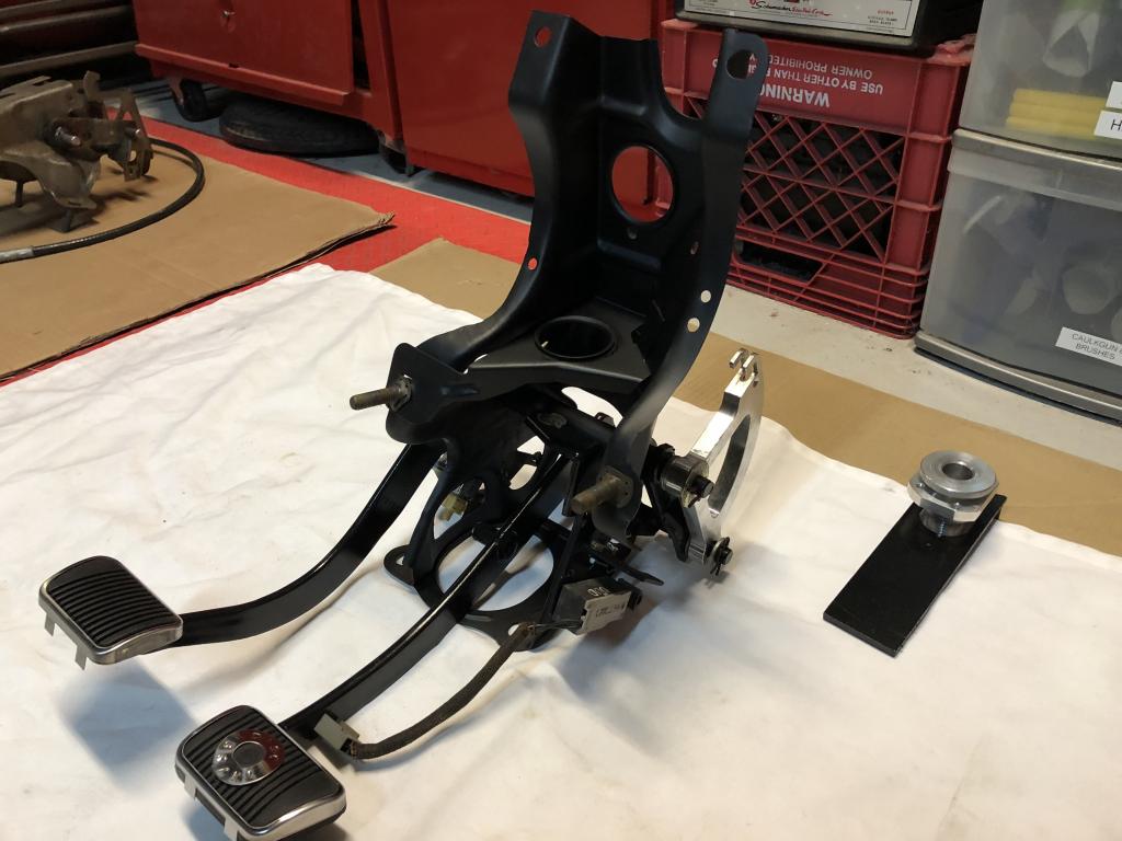

                            Been doing endless research on getting this 5speed swap down...the boring part of it...wiring.
                            I'd like to wire in all of the special doodads if they fit underneath the dash. They all attach to the pedal assembly:
                            p.side has the cruise control deactivation switch
                            d.side has the clutch neutral safety switch which consist of two doodads. One (top port (black connector(not pictured))) allows the power to the tfi and the starter solenoid when the clutch pedal is fully engaged while the other (bottom port(gray connector(not pictured))) tells the computer that the transmission is essentially in neutral/not engaged when the clutch pedal is fully engaged.
                            Cruise thing is easy. Intercept the output of the stop lamp switch (mounted on brake pedal) and plum it in then out of the cruise control deactivation switch.
                            black plug (top port) is not too bad either. Just redirect the wires to from the auto tranny mounted neutral safety switch to this plug and Im good.
                            gray plug (bottom port) requires a bit more work. Looks like I will have to add a pin to my ecu connector (pin 30) and the other half of that is just off pin 46 which is the sig return pin.
                            all in all not hard. Again, no clue if any of this stuff will fit. Just things I would like to do if it is possible.
                            Did a bit more digging with this and found an error in my previous descriptions. Turns out the gray plug also ties into the neutral switch on the transmission. So the transmissions physical switch tells the computer that it is in neutral and the clutch mounted switch tells the computer it is between gears (pedal depressed).

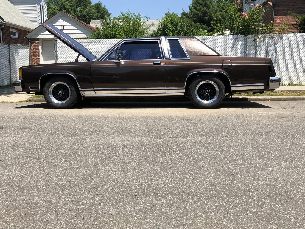

                              Havent started her up in about three weeks. Turned the key today after work and she kicked right over. Gotta love that!
                              Anyways here she sits with the dd Benz behind her.
                              Hot as anything outside so I decided not to play around with the AFR gauge. It came back from Autometer saying everything was fine with it. They threw in a wide band sensor free of charge and then I picked up another harness that goes between the gauge and the wide band sensor. Will test out everything to see what the hell is going on once the weather gets to a more reasonable temperature.
                                Mighty fine looking car, sir. You must get tired of hearing that. I love the wheels on 'er too, the bright rim is a great look and goes with the other brightwork on the car. Absolutely love the car and wish it was mine. What would you think about putting that opera light band in that came on the full roof ASC cars? Or the LTD Landau light that was on what, '79-'82 cars?
