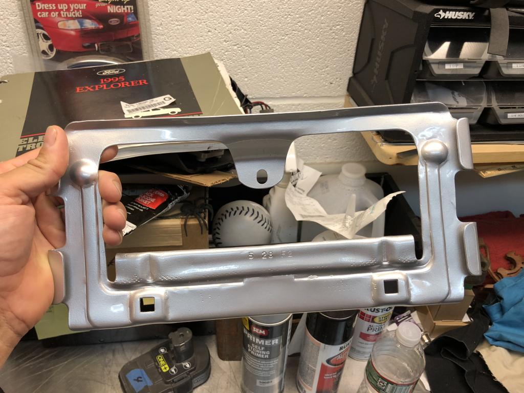

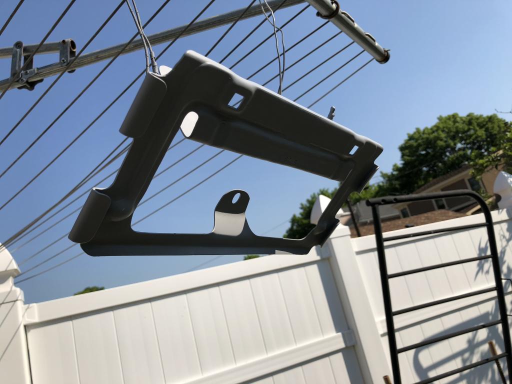

              Also painted up the modified 1987 crown Victoria front license plate bracket. Modified as I had rebent it to fit the 1979 bumper I recently picked up. I primed it a couple weeks back and just scuffed down the primer today with a gray scotch brite pad and painted it with some ford silver frost metallic paint I had around (left over from repainting the fancy 1979 CV rear chrome license plate bucket) and cleared with with some spray max 2K clear. Its good looking. Used the rest of the clear coat (has a pot life) on the front license plate bracket I was repainting for the Mercedes. God do I LOVE that clear coat.

                And a shot (shitty shot at that) of the license plate bracket in primer just before paint was applied.
                Of course I forgot to take a picture of it all done. Its shiny has all hell. Spraymax 2k clear is great.

                        Here is the front license plate frame that I had bent up to work for the 1979 center plate mount bumper. She shines.
                          Whats different about the mounting method? Looks like you had to bend it to bolt in from the bottom, and I guess the 87 bolts from the front?
                            They both bolt in from the bottom and the one hidden fastener behind the license plate. The difference is the depth at which they bolt to the bottom of the bumper.
                            The center mount plate bumpers front license plate bracket sits lower that the off set style type bumper license plate brackets. So when I fastened the 87 style to the 79 type the lower mounts were no where near the bumper. I had to bend up the bracket so the mounting ears would sit flush against the bumper.

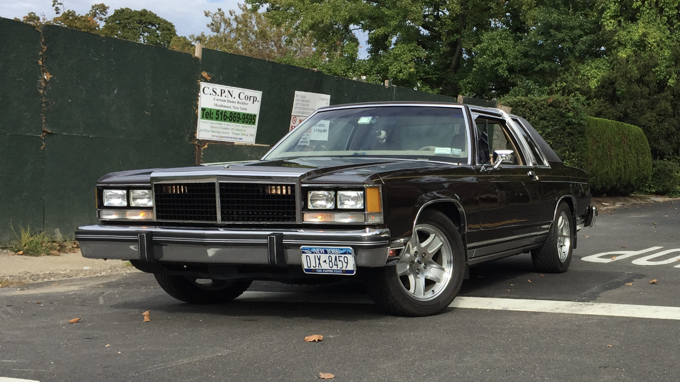

                            And my car:
                            Visually they look damn near the same. I was quite surprised that the one I pulled from a 1986 CV was not correct for the older center style bumpers.
