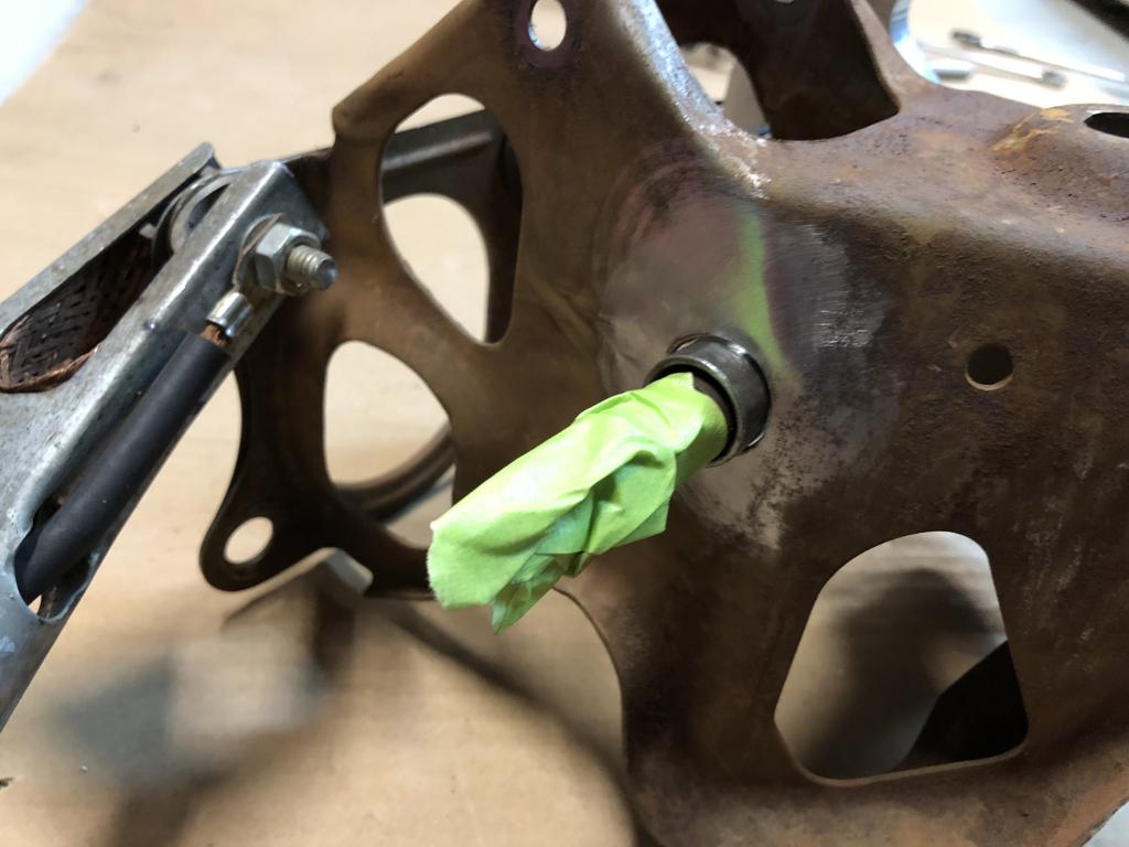

              Ground out the clutch pedal tube from one of the spare fox body pedal assemblies I had. Now to determine where to drill in the spare panther pedal assembly I have. Once that is determined I will go ahead and make my pedal cover pads fit to my liking.
                I did things..
                Test fit clutch pedal tube:
                Welded in the clutch pedal tube:

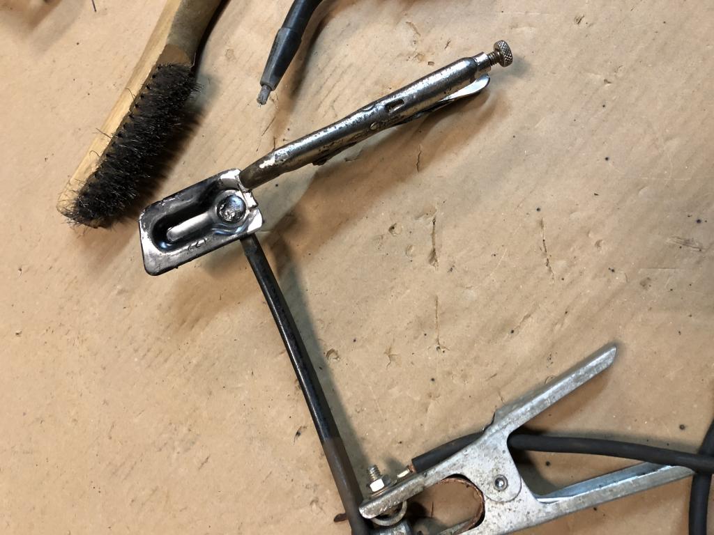

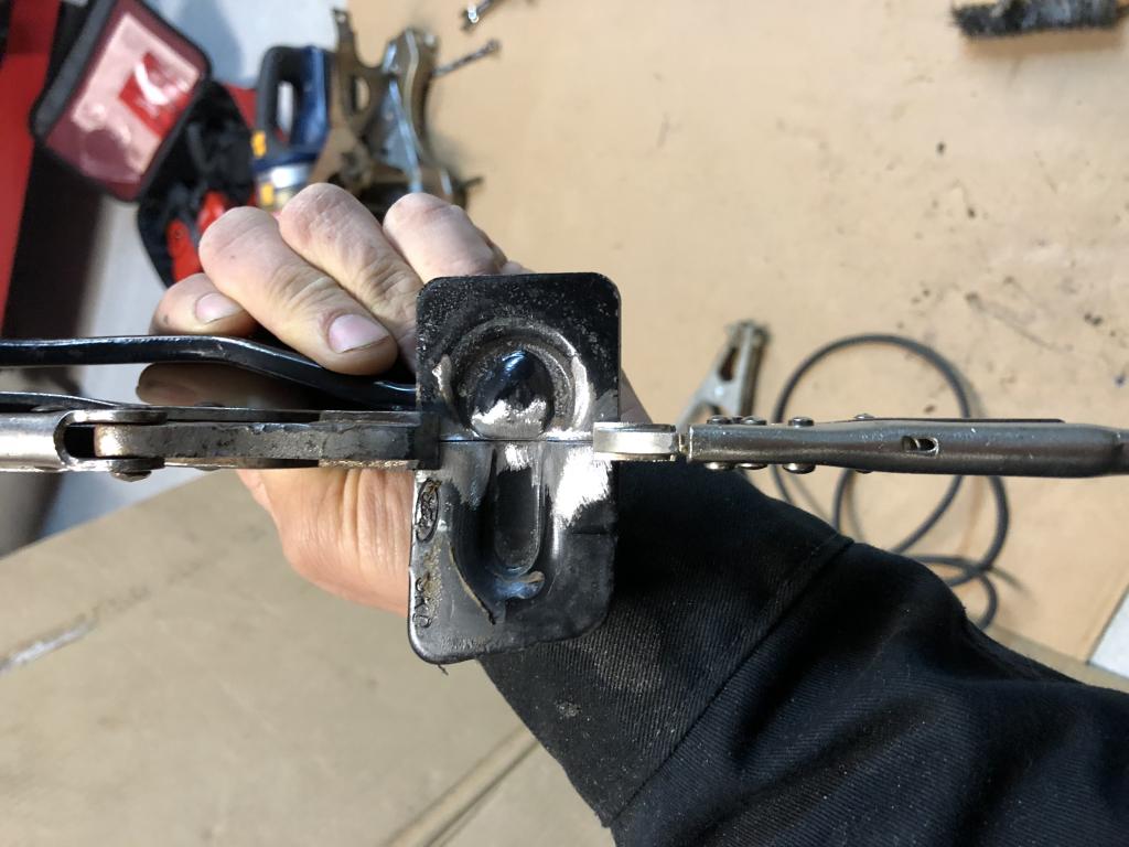

                Then started working on my pedal pads. I did not want stock fox body mustang ones so some fabrication was needed.
                Cut the brake pedal down:
                And used its scraps for the clutch pedal:
                All was well after that:

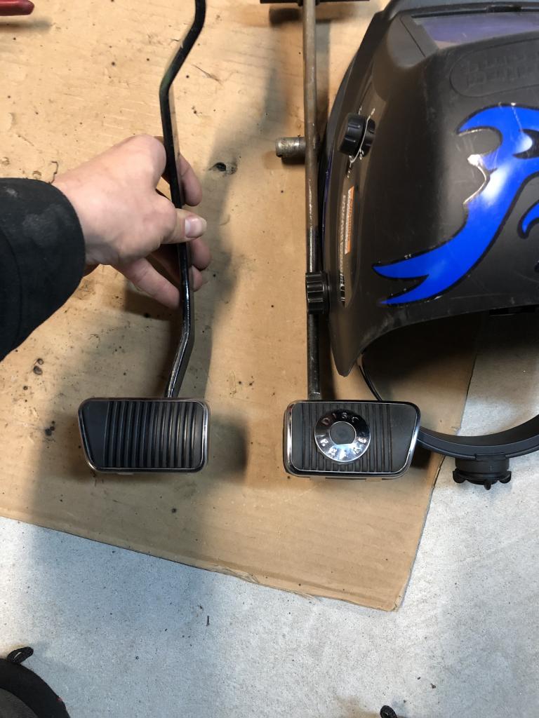

                With pads and bezels:
                And on the pedal box without the bezels:

                    Looks good. What are those pedal pads for? Looks bigger than typical car stuff, F-series ?
                      I like where this is going. Pedal pads appear to be 65-early 70’s Ford compact/midsize car?
                        I sourced them as 65 to 73 Mustang pedal pads. Like anything ford I am sure they are used in many other models. I really like having the brite work around the pedals and these fit the bill perfectly with added bonus of brake pedal pad having a "disc brake" piece of brite work.
