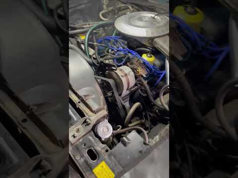

Popped the aftermarket intake off today. Determined, visually, it was not machined properly and kinda curves towards the thin side of life at the top and never even sealed fully against the gasket. Oops.
Anyway, cleaned up the 2BBL intake and slapped it back on along with another 2150 clone, but with proper gaskets from FelPro. Performed camshaft break in using conventional 10W-40 and Lucas ZDDP additive. After break in, changed oil again with the same 10W-40 conventional and half a bottle of ZDDP.
However, there’s a tapping noise on the passenger bank. It goes away if you increase RPM above 1500, but on decrease it’ll come back. Mind, the old lifter/cam combo would click/rattle while coming down if you revved the car, however I’m not 100% it didn’t click at idle because the old flex fan was very loud.
You can hear it towards the end of the video.
I have verified all the push rods are turning, no one is stuck/stationary. I’m not suspecting a lifter just going flat, however I’m wondering if one’s not staying pumped up. All the rockers are torqued to 20 ft-lbs and none seem loose.
Engine seems to run fine, just gotta get a little final adjustment done with the carb. It finally does idle decently in gear.
