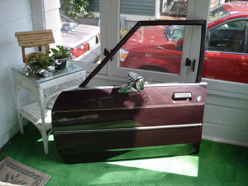

First we removed the door, if you have no power options (power locks,windows, mirrors) It's far easier as you dont have to have the door really close to the area your working due to wire length. If you do have the power options the door will need to be propped up using 2X4's or something of simular structure.

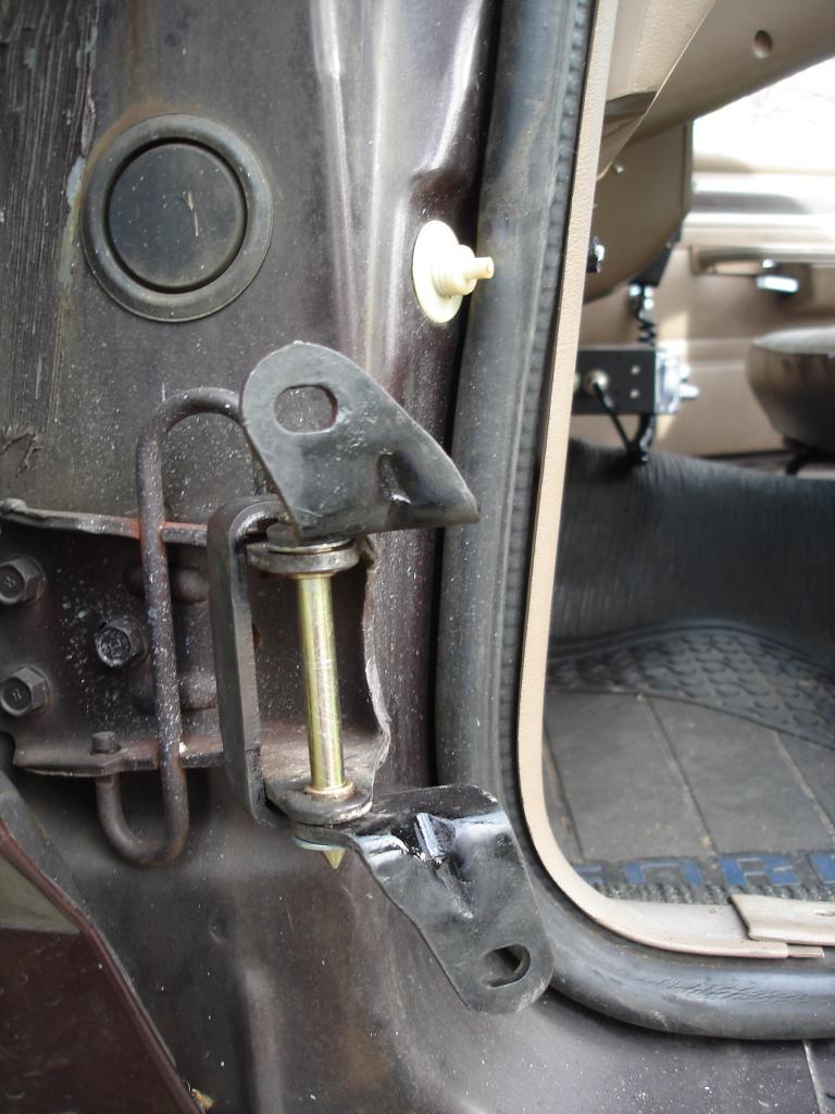

Old Pins:
NEW!!! (notice the steel washers this was in my 82)

Old Pins:
