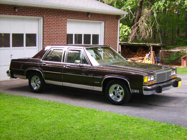

                  So I've been busy even if it doesn't show in this thread. So far the top is sanded. I found rust under the paint exactly where I thought it might be - in the center where the original paint was cracked.
                  The top in the process of getting sanded. If there is any rust, it will need to come down to bare metal in those spots. Also, any places you plan to bondo need to be down to bare metal if at all possible.
                  More sanding. The center had to come down to bare metal after this picture because of rust hiding beneath the paint.
                  The intermediate coat of bondo on the C-Pillar seams.
                  The top being sanded. Note the B-Pillar still has no bondo.
                  THE PAINT!
                  Updates not shown in the pictures:
                  The holes for the crown on the top were filled and that area is ready for paint. I probably have about seven hours just on that.
                  The C-Pillar seams are pretty much ready for paint as well.
                  The B-Pillars need some final touch up bondo work to make them pretty.
                  The headliner and sunvisors are at the shop getting recovered, all for $80.
                  I'm sick as a dog with some kind of flu crap. So I probably won't do much with the car today even though I have the day off. I might get the bondo work finished, depending on how I feel after lunch. Maybe primer Saturday, or most likely Monday. Wet sanding throughout the week, and maybe top coat next Saturday (June 23).

                        87_crown_vic, the C-Pillar trim comes off by removing the rear seat, the package tray, the inside rear window trim, the package tray trim on the sides, the inside upper rear window moulding, and the headliner side panels. A nut holds it on the front, two plastic retainers (pull to remove), and a clip on the back side you need to slide the moulding out of. A lot of work.
                        So yeah it's done! And looks freggin' awesome. Better than I expected actually. The C-Pillar moulding doesn't look too out of place. The seams turned out great and the top came out pretty good. I put some extra thinner into the final coat to dull it down slightly to match the rest of the car better. I did most of the priming, but my dad sprayed the final brown coats.
                        Speaking of the top, it took a ton of sanding. I thought it was okay and then I primed it. Yuck eek! It was bad. So I sanded it down and the bondo eventually developed a pattern along the edges like a snake. You can see the beginnings of it in the picture before I primed it in the center of the roof.
                        This needed a lot more sanding. About two more hours worth to be exact.
                        And it's magically done:
                        In closing, let me say dial up sucks. I have 6MP versions of all these I'll probably add later.
                        If anyone has any questions about the process, PM me or post.
                        Slicktop > Cracked Vinyl

                          You did a great job. You welding up the holes from the trim right?
                          2000 Mustang GT "Blondie", 2000 CVPI "Sargent Crusty"
                            #28
                            Hot damn, that's an amazing looking car. Slicktop is definetly better looking to me then half vinyl roof, but I still think the full coach roof option looks great.

                              that looks damn good. im not going that route. i am doing almost all the same work though. i am leaving the crown on it and doing a faux vinyl top i guess you can say. i am making it look like a black top area where the vinyl was at. you are more than welcome to work on mine since yours looks so damn good
                              Addicted to 86-87 Panthers
                                #30
                                Excellent job mang! It looks perfect.
