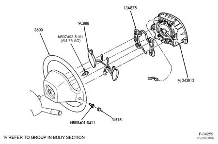

    Remove the negative battery cable. Tap the brakes. Wait a minute for good measure.
    Remove the bomb by removing the nuts on the back of the steering wheel.
    unplug old wire harness to buttons... remove buttons... reverse with new buttons.
    see breakout diagram from fordparts.com

              Ah-ha, my famous last words have returned to sort of 'haunt' and 'taunt' after all. First off many thanks for the very *easy* instructions on removing the airbag bomb assembly *after* the primary battery is fully disconnected and any capacitors are fully discharged. I just got back in from doing what I could for today and removed the bomb. Then the electrical connectors ( actually more of a pain ) and then...I finally realised that, yep, the steering wheel has to be removed in order to even get at this buttons let alone replace them. I had a premonition that this 'might' be the case and it appears to be true. Rats! Still, it looks fairly easy?
              While I have photographs and HD ones at that, the primary culprit appears to be the torx screw or bolt holding the steering wheel in place %$#@!. It says '89' or '98' on this critter and I don't have any that large for starters and will have to purchase one. While the FSM arrived yesterday, I am not sure where to look for the exact 'size' of this torx insert. I can only guess. Anyone know for 101% certainty it's number or value? What is the torque specification for this on it's way back in also? Again, maybe the FSM will have this all and I will search now.

                  Yes indeed! I just looked at the FSM and the instructions are fully horrid. It ( the bolt ) is referred to as the steering wheel retainer bolt and one I'm supposed to 'discard' after removal ( Duh?! ). I will search for one at Ford Parts.com and yet I will need a specail steering wheel puller also. More fun eh? Shoot. It looks so easy and simple, but there is no way around the plastic shroud, and no way to remove it or pull it aside apparently. Now I am pissed. As with all such things that appear difficult, what I might do it pay a visit to the local dealership and buy a replacement bolt and pray that they do not change $14.95 for the damn thing plus tax here which adds another ten % onto everything. Maybe I can obtain some instruction or tips from them or.....pause.....wait to see *if* this switch cleaner and lube has any effect on the 'set' position for this two part switch assembly and play the game from there. Shoot! So close. I am going to just go out and find a girl friend and leave this to god or something?!!! I'll be back with this *after* I obtain some facts in this maddness. Still, it's nothing compared to the ignition cylinder bearings and the retainer! Talk about a trip to hell, but there are various versions of hell and we have all walked there. I am not going to allow this to get to me. So for now I am going to slow it down and obtain more information, one step at a time as removal of the wheel actually looked easy until I read about the silly puller! I can rent one and have another inside here that I never used. So let me check on this pricy bolt from the fellow at Ford, the one that is supposed to be torqued to about 32 foot lbs when replaced.
                    meh... I wouldn't worry about reusing the bolt. Just put some blue locktite on it when you put it back in.
                      I don't know of the 1998, but look at the wheel, if you see threaded holes on either side of the mounting bolt it uses a conventional steering wheel puller. If there are no bolt holes, a conventional 2-arm puller is all you will need. Take a look and you will see to ridges to hook the puller behind.
                      No service manual gives you wrench size needed, they assume you have full sets of everything. And you should, given the ever widening use of torx fasteners.
                      The numbers you see have nothing to do with the size, it is the strength rating of the bolt. Probably going to be a t50 or t55.
                      Personally, I'd reuse the bolt. Tighten it, but don't get all gorilla armed on it. It is there to keep the steering wheel from getting pulled off the shaft, not to transmit turning forces.
