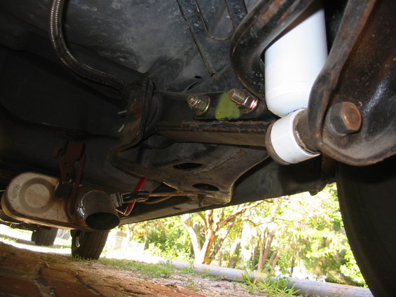

            for the hell of it, here is a control arm mount. the inside portion of the mount is not braced very well so some additional material would be good.
              is that a boxed LCA? it looks different.
                yes it is, i boxed mine before i even got it running. just a strip of 1/8" steel welded to the arm
