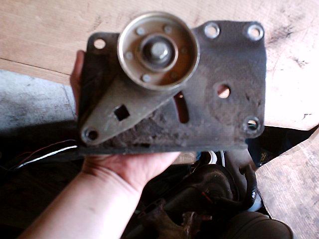

        i got the assembly out, i was just wondering how i'm supposed to get the old pully off and the new one on, the part they gave me when i asked for the belt tensioner pully was just the pully itself.
        oh and the bolt sizes were 15 mm and 9/16, 9/16 for the swivel bolt and 15 mm for the bolt under the a/c compressor
        edit, heres a pic of what it looks like (taken from this site upon searching) thats what my assembly looks like but with the factory tensioner, i just pulled the tensioner bracket not the whole thing like in the pic.
        Nick
          You didn't need to remove that whole big bracket. When I bought my tensioner, they gave me the piece at the top which is the idler wheel and the small metal bracket with the square head hole in it only.
            i know, lol, thats someone else's pic, i only pulled the small bracket that the pully is on, 2 bolts. what i'm asking is, is there a way to pull the old idler wheel off the factory bracket to install the new one like the pic shows cuz they only gave me the idler wheel, not a new bracket? again thats not my pic but my bracket and pully is the same cept my factory pully is still on there, not the new replacement that i have, thats what i'm trying to do replace the factory idler wheel with the new one i got!
            Nick
              I think the factory ones are riveted like mrltd said. If it doesn't have a bolt through the middle, you can't pull it off. Take the pulley back and get the right part. I had the same thing happen to me, but I lost the box for the pulley and couldn't return it. It was actually an idler for a Mark VII anyway, so I just gave it to a friend that has a few LSCs.
                ahh, got-ya, i'll take it back and get the right part tomorrow, thanks man!
