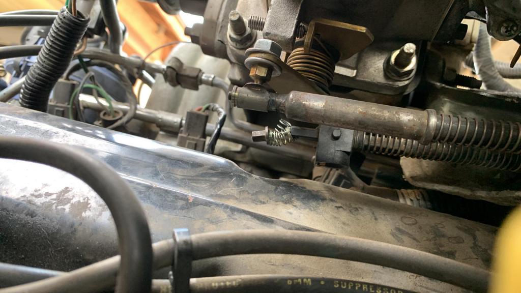

    Broken one on this 89 5.0 base model makes it hard to drive and all sources say it is 19" but dealer claims there was a short lived 17 inch one that they cannot get. Is this a big lie or can anyone provide a source for shorter cable or is there easy mod to start using 19"? Thank you.

    something on site is broken; I cannot reply to myself with image. might try posting a second post.

        something is funny with that throttle body stud. The OE ones are not bolted on like that, it should be welded. That doesn't look like a stock throttle body to me, might be worth a closer look to see if someone has done something strange.
        Make sure the ball stud isn't rusty and has a bit of grease in there. I thought I had a bad throttle cable on mine, rust was the issue.
        anyway the Ford master parts manual lists one part for all 86-89 5.0 cars, E8AZ-9A758-A at 17 3/8" long.
        There are others for earlier stuff and the 351 cars, none of them are 19". They range from 21 1/2" to 22 5/64" in length.

            thank you. I tried to find that part number and there is a cross number to something completely different like y-127 or something. Its detailed description says it is 19" though not 17 3/8.

              Don't know what to tell you, aftermarket part may be different or measured to different points. Or maybe its Chinese inches. The Ford master parts manual says what it says.
