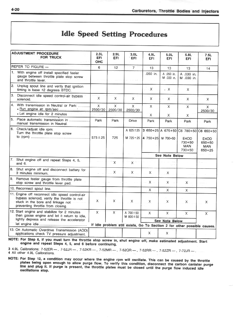

              Also, here's the idle set procedure for F150s. Use the 5.0L list but ignore the feeler guage stuff and set timing to 10 degrees BTC of course.
                Thanks all!
                  Cool schematic, sly!
                    I should actually have the ones for cars in one of my manuals, don't remember if that has the feeler gauge stuff or not. I have so damn many manuals these days. If you've never had hands on a complete powertrain control and emissions diag manual its quite a beast.
