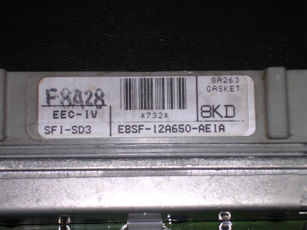

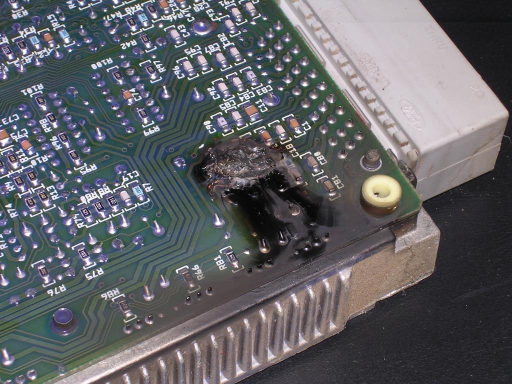

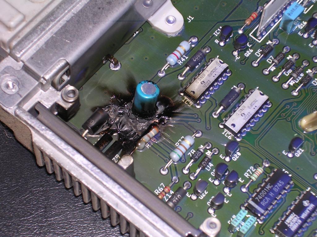

Died on me on the way home today... waited a few... cranked back up and I drove home. Go out and test it... pulls code 18. Tach signal lost? wtf?
hmm... do a koer test... engine starts to rev up (advance progressing) and then just dies. Try to crank it again and nothing.
*sniff*sniff*
smoke?
engine computer case is too hot to touch. Try a koeo test to pull codes... nothing. no response. anything I should check besides the computer?
Fuel pump comes on and stays on now with the key on. all accessories work fine.
