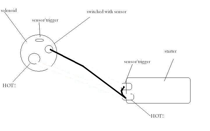

    okay cool. And this is what some others are doing to simplify the wiring?
    Or the opposite jump down at the new starter?
      #32
      Yes, and that is essentially what this kit from Summit does for the Chevy crowd. It includes a jumper bar of metal to connect the two positions on the starter solenoid, and then you hook up the remote mount 'Ford style' solenoid somewhere else.
          This is what I'd do - I hate running extra wiring where there's heat and high current draws, this way everything is still rather self-contained and less likelyto rub against shit and melt and short out.

              I'd be concerned about the new starter pulling more amps than the relay can handle. Hook it up the way the factory did it. Its probably that way for a reason. The new trigger wire has really small current draws, so you don't need a large wire. 16 ga is plenty.

                Essentially, with installing a new-style starter, all you are doing is putting both big battery cables on the side of the original old-style solenoid closest to the battery, and simply unplugging the small 'S' wire from the solenoid (it should be marked), extending it, and hooking it up to the 'S' on the new starter.
                I've done this over a couple of dozen times with customer vehicles and my own cars over the last decade and a half or so, after mistakenly discovering that the 91-up cars had the small starters....and they worked pretty well with higher-compression engines. I refuse to install an old-style starter, unless the customer is insistent on keeping the old-style in there, as the new-style is simply a better unit.
                This seems real easy. I haven't been under it yet but there's only one wire going to my old timey starter, right?
                Which wire is it on the solenoid? Since you said unplugging I'm assuming it's the 90 degree boot shaped little guy.

                  I also, obviously, don't know dick about the fender solenoid. Basically any information I can get that would be useful when doing the wiring changes...
                  You're putting both fat battery cables (+/-) on the side closest to the battery itself , and then just moving that tiny wire OFF of the solenoid and ON to the new starter? Am I reading that correctly?
                  What are the positions/terminals on the starter itself?
                    So with this method I'm just jumping the terminals together down on my starter?
                    Does wiring remain the same up above, or..? Sorry for the persistent and probably stupid questions guys, I'm mechanically and elctrically retarded and want to make sure I'm not blowing anything up before I turn the key
                    The only wire running to my starter now is the hot one, correct?

                            Why does this not work? I used a mini starter so I could get to town for parts and this was all I did, it worked fine. (Keep in mind I didn't care how good it looked as it was for that day only)

                                So after all this all I have to do is jump the two bolts together on the small starter! No other wires are needed to use the smaller starter? Just take the big old one out stick the new small one in, jump the bolts together, put the old wire back on, and it is good to go?
