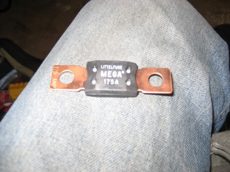

                  Whenever I get back to the junkyard I'll pick one up, and then I'll do the wiring. Where can I get an inline circuit breaker for the charge wire, and how much do they go for?
                      I just used the "Mega Fuse" that's run with the 3.0 taurus charging circuit. It's a 175 amp fuse and it looks like this
                      This is the fuse that protects the charging circuit on the taurus that you're getting the alternator from.
