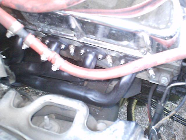

HO headers on!!!!
    HO headers on!!!!

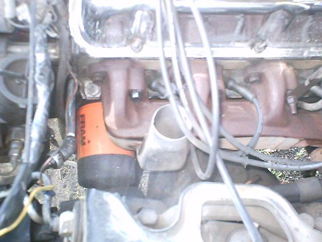

    The shitty ass stock manifolds. And yes, I should be ashamed of myself for having a Fram filter on GL, but I got a nice Motorcraft filter begging to be put on. Plus I've never had problems with the Fram filters.

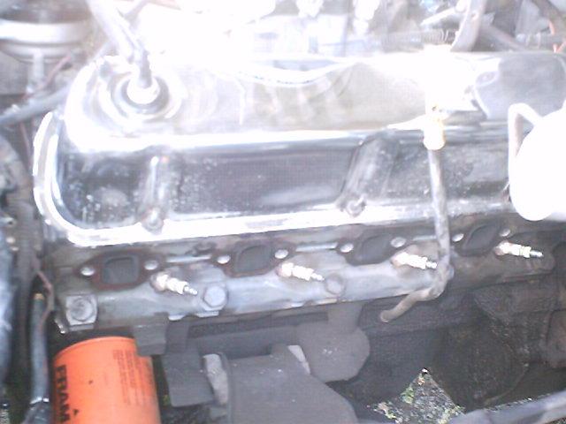

    Too naked without something bolted there. All the manifold bolts were loose. I could unscrew them with my fingers. I'm surprised they didn't leak at all.

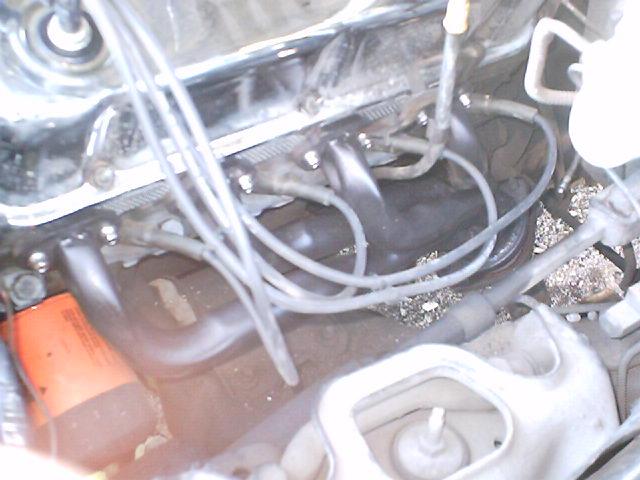

    One down, one to go. The bolts I used I bought from summit racing, they have 3/8" heads. They work pretty good.
    All done! GL is a little louder on acceleration, and I haven't had a chance to see what kind of performance gains they have made yet.

        What did you paint those with? They look good.
        Chris - A 20th Century Man \m/ ^.^ \m/
          I don't have the H pipe as of yet, don't have enough $$$. I used the downpipes from teh stock manifolds. They require a little modification, but they will work with HO headers. The paint I got from Wal-Mart, it's this 1500 degree stuff. I can't remember what it's called. The spray can says it is black, but it looks brown to me lol.

                Okay, so everyone knows that the studs on the HO headers are spaced wider than the studs on the stock manifolds, so the other end of the clamp for the stock downpipes wont work. All you have to do, is cut out one of the holes on the clamp, to make it a slot. Then teh clamp will slip over the studs on the HO headers, and there ya go. I don't know if it's actually called a clamp or what, I really don't know, but you get what I am saying.

                  When I put mine on I used a POR-15 product called Black Velvet that I had sitting around from a previous project. Worked fine, but they turned a slightly ashy grey color once it got hot. Sticks on there just fine tho.

                        The paint I used is Dupli-Color High Heat Ceramic paint. It is good up to 1200 degrees. When I first started up GL, the headers smoked pretty good, must have been burning off the excess paint or something. They are also starting to turn grey.
