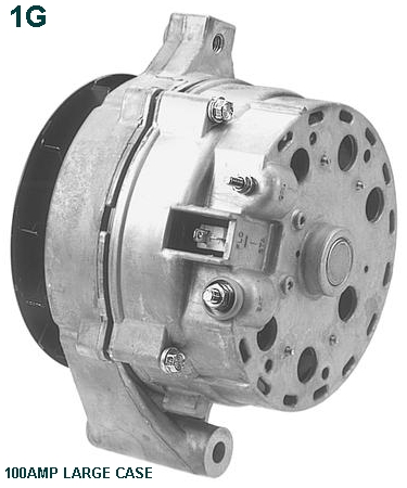

          If that's an 86 with an 351, it might have the 100 amp. Either way you slice it, you need some wiring changes.

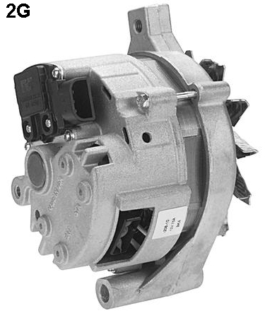

          2G 65A
          1G 100A

                That's the 2G. Highly recommended to upgrade to the 3G. If you need more amps, they are available. I'd suggest calculating what you need.

                            Looks like the small case 2G, so there’s plenty of options to choose from for a small case 3G, like ‘94-‘95 V8 Mustang, ‘94-‘99 V6 Mustang, or ‘95-‘99 OHV 3.0L V6 Taurus/Sable. Those options all offered an appropriate sized 130 amp 3G.
