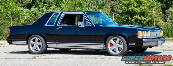

                Pretty sure this is the car i was thinking of:
                Looks like this is what is listed for suspension mods-
                Steering Suspension and Brakes:
                Moog pitman arm, upper ball joints, idler arm, inner/outer tie rods
                Steeda X2 lower ball joints
                Lowering springs at 2.5" drop from www.coilsprings.com
                Addco front/rear sway bars
                Metco rear control arms
                Bilstein shocks
                ENS polly hardware
                Russel stainless steel brake lines
                98-02 big brake upgrade
                Hawk HPS brake pads
                Powerslot rotors
